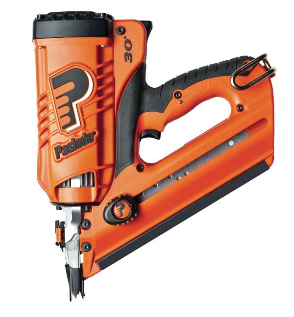

Paslode CF325Li
Paslode invented fuel-powered nailers more than 25 years ago, and the company's experience shows. Its newest tool, the CF325Li, has several upgrades over previous models. The nose has been redesigned to make toenailing easier. Depth-of-drive can now be set without tools, by squeezing part of the nosepiece. The adjustable belt hook is large enough to fit over 2-by framing — which is important because even though the gun is rugged, it's more complex than a pneumatic and I would not want it to fall from a height.
One of the best new features is the lithium-ion battery. It's smaller and lighter than its predecessor and can be charged enough in two minutes to drive an additional 200 nails. To avoid draining the battery while the tool is in storage, you can pull the battery out until it clicks into a position where it no longer touches the contacts. This means you don't have to remove the battery (and risk losing it) to prevent it from losing its charge.
Paslode also redesigned its fuel cells to make them faster and easier to load. Loading the gun is a matter of dropping in a cell, pivoting an adapter piece onto it, and engaging the cell by closing the actuator cover. You used to have to manually engage a tip on the cap of the cell. The new-style cells can be adapted to older Paslode tools and other brands of fuel-powered guns by installing an included adapter cap.
The CF325Li takes 30-degree paper-collated fasteners. Paper-collated nails have traditionally had clipped heads, which cannot be used in our seismic zone. Paslode's paper-collated nails have full-round offset heads, however, and comply with wind and seismic codes. Paper-collated fasteners require more care than plastic- or wire-collated nails; if you leave them out in the rain, the paper may soften to the point where clips will jam in the magazine.
The manufacturer has shown some creativity in the way it markets the consumables for this tool: The nails and fuel cells are packaged together, so if you have one you have the other. (And since there is more than enough fuel for the number of nails in the pack, you'll have an extra cylinder left over after using several packs.) The gun accepts other brands of fasteners, but according to Paslode it works best with the company's PowerBoost Black Tip Coated nails, which are designed to be easier to drive in hard material. We noticed the difference — the PowerBoost nails were less prone to breaking in hard material (like LVL) than the offbrand fasteners we normally use.

The Paslode CF325Li and the Bostitch GF28WW both work better than the fuel-powered guns I've used in the past. Earlier models had a reputation for being finicky — sometimes they worked great and other times they misfired or refused to fire at all. Toenailing could be tricky because you had to search for just the right angle to get the gun to fire. I experienced very few instances of misfiring with either one of these guns, and toenailing was easier. Both guns have the power to drive nails in engineered lumber such as LVL, though you can't nail as fast as you would with a pneumatic.
