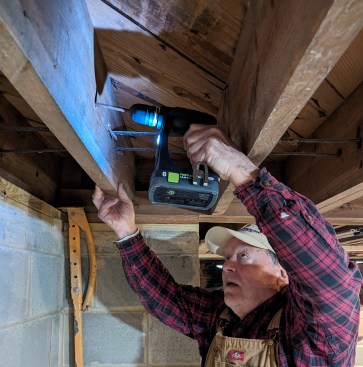

Measuring just over 6 inches long, Festool’s CXS 18 fits easily between joists and has the power to drive large-diameter structural screws.

Although the CXS 18 is considerably more robust than the CXS 12, it’s still a light, compact drill that measures a mere 8 1/4 inches tall and 6 1/4 inches long and weighs in at just 1.54 pounds. Despite its diminutive size, however, it has plenty of power. It doesn’t have an impact action, but it drives 3 1/8-inch construction screws into framing lumber with ease, and it’s rated to drill 1 3/8-inch-diameter holes in wood. The brushless motor runs smoothly and, in use, it’s well-balanced and feels good in the hand.
In addition to its smooth and powerful drilling and driving operations, the CXS 18 comes with an array of clever and useful features. One of my favorites is the LED light. In the remodeling work that I do, I often find myself driving screws in dark, confined spaces, such as inside cabinets or in bays between joists, rafters, or studs. In these situations, the LED light really helps. It can be adjusted for both brightness and duration via the Festool Work App (which is actuated through Bluetooth). Because the light can be set to stay on for up to 15 minutes, you can use the drill as a makeshift flashlight.

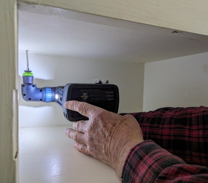

In addition to the Centrotec chuck, Festool offers a variety of interchangeable chucks that can be installed via its “FastFix Interface.” The HPC 4,0 I-Set that I tested includes two of these chucks (along with the Centrotec): an AN-XS right-angle bit holder and a keyless 3/8-inch drill bit chuck. Both click securely in place by hand. The right-angle bit holder can be rotated clockwise to fine-tune its orientation to the drill body, which helps fit the drill in tight spaces.

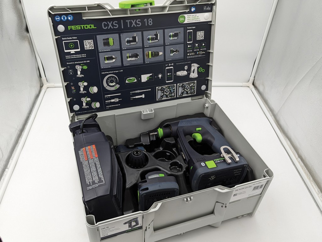

The CXS 18 HPC 4,0 I-Set includes a CXS 18 drill, two 18-volt batteries, a charger, the three chucks described here, and the belt clip mentioned above. All the components are neatly arranged in a custom Festool Systainer 3 toolbox and held in place by a hard plastic lining that’s molded to fit them.

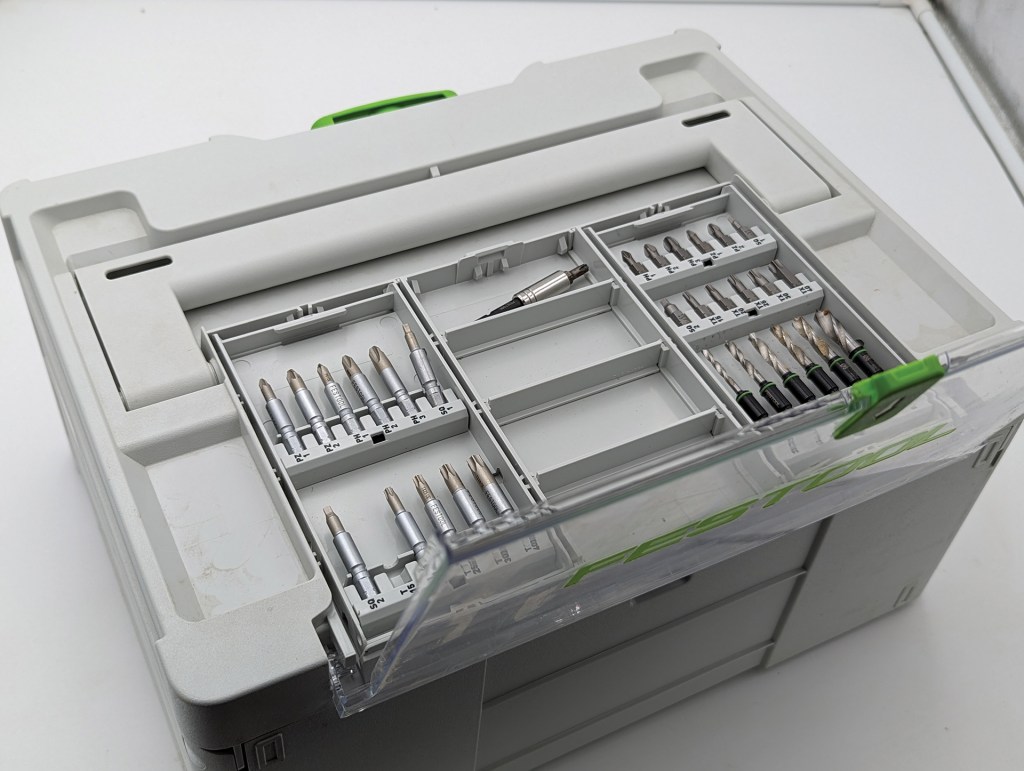

Festool’s Systainer system is modular. In addition to stacking neatly with other Systainer boxes, this one houses clear bit cases that clip into the lid. Inside the cases, the drill and driver bits clip into magnetized slots. The cases fit precisely in compartments that are molded in the lid and covered by a clear lid. The result is that 40 or so bits can be neatly and securely arranged and clearly visible on the lid of the Systainer. (see photos below)
