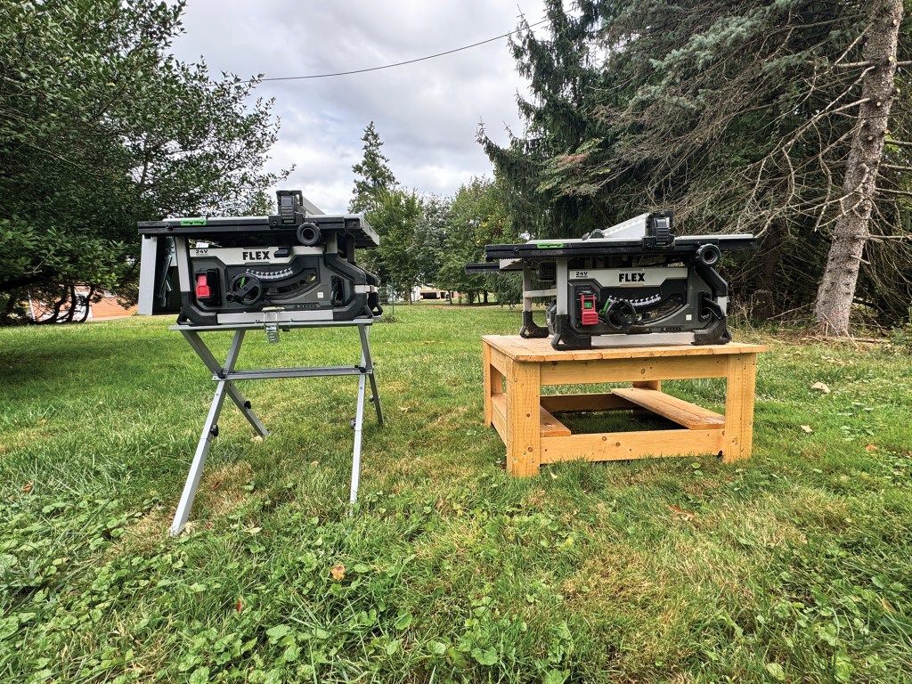

The Flex cordless table saw is available in 8 1/4-inch (on stand, at left in photo) and 10-inch (on table, at right in photo) models. The stand can be configured for either model.

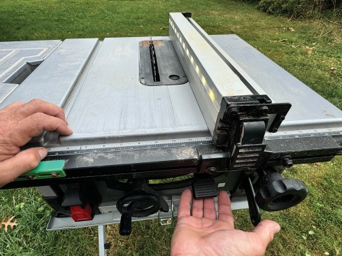

The 8 1/4-inch saw is compact with a folding, extra table section to the left of the blade that claims best-cut capacity in its class for ripping sheet goods. I’m not a big ripper of sheet goods with table saws, but I hoped the fold-out section would be a good base on which to store the saw in my service body truck. It wasn’t. The saw tipped easily off its side. I don’t use the fold-out much, but it’s there if you need it and out of the way if you don’t. Hardware works well, but it adds weight to the 50-pound unit. For the material I rip, the cut capacity of the 8 1/4-inch saw works on 95% of what I need ripped with less blade plate resistance.

Fence locks. I need to give a shout out to the fence lock on the 8 1/4-inch saw. I’m not saying I like it; my years-long muscle memory of reaching under the table doesn’t like it. But mechanically, it is an easier reach. The 10-inch tool has the comfort-food edition of an under-table fence lock. Both saws lock hard and snap into place. Engaging the locks does take some oomph; the lock on the 10-inch is actually loud.
Both saws have a lighted fence to increase visibility at the cut line.

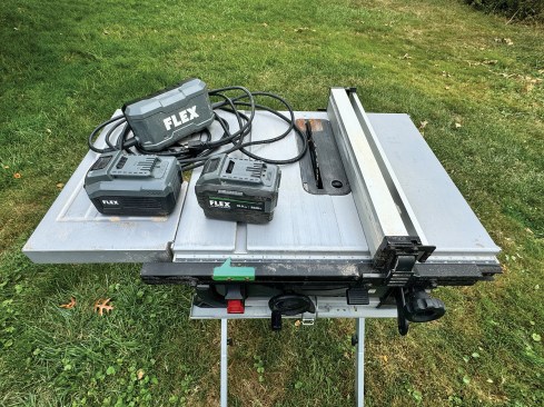

I didn’t notice anything atypical in the materials I sent through the saws. Both saws cut smoothly, and the battery life on a cordless table saw still surprises me. That said, I ran out of juice with no real warning. The saws either start struggling or stop altogether, depending on the load, and I had to go to my battery farm to get back in the game. Should that be a chafe for you, like it is for me, you can buy the company’s AC/DC adapter. It’s unwieldy-ish (as is every other one I’ve seen) and takes up truck space. With its (sometimes maddening) fan-whirring transformer one-third of the way along, its otherwise generous 20‑foot lead cord provides ample reach.
Shown in photo are a 10-Ah battery (foreground, at left), included with the 10-inch saw; a 6-Ah battery (foreground, at right), included with the 8 1/4-inch saw; and an adapter (behind), sold separately.

Stand. Both units use the same folding X-stand, which has one configuration for the 10-inch saw and another for the 8 1/4-inch saw. Assembly is required. Dragging from truck is also required. Both saws weigh about 50 pounds but feel way heavier than the Skil unit I have (also about 50 pounds), which has its stand built in. The Skil is much easier to set up, store, and manage.
Storability and portability. While I have a bowling alley in the back of my e350 service body, that room is not infinite, and I need to travel through it. Both saws must be stored on their bases—not on their sides like their sister Skil can be—and, being separate, the stand takes up more room. The Flex saws also require two extra trips to and from the truck for setup and break down compared with the Skil. On the plus side, unlike saws tangled up in fancy collapsible stands and wheel kits, the Flex saws can be moved in and out of a jobsite, through a door, and upstairs by one person.
