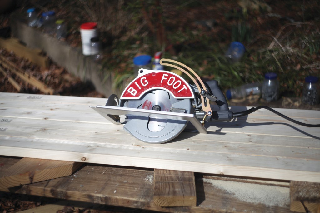

The Big Foot 10 1/4-inch beam saw can be retrofitted with a powder-coated-steel swing table that adjusts to a 75-degree bevel with a 1 1/8-inch depth of cut.

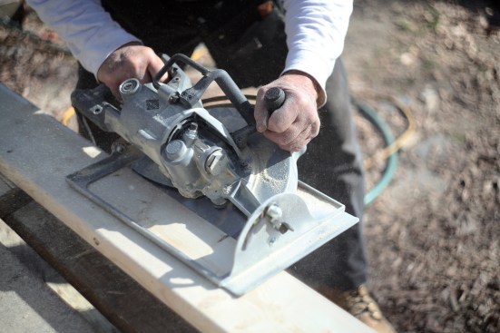

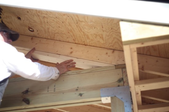

Here, the author demonstrates how the swing table allowed him to rip a 61-degree bevel for the sleeper in a blind valley for a roof that he is framing.

This ability to cut very acute angles might seem to be an exotic feature, but I’ve found it to be extremely useful at key points during my jobs. I use it to do things like make the bevel crosscuts needed for the level and inclined plates used when framing a gable-end wall. On a 6-in-12 pitch, those cuts would need to be 63 1/2 degrees. I also use it to make the compound miter/bevel cut needed for an octagonal roof. At the tops of the hip rafters, the saw would have to be set to 67 1/2 degrees for those cuts. I also use it to rip the bevel along the length of the sleeper in a blind valley. On the one shown here, I ripped the sleeper at 61 degrees.

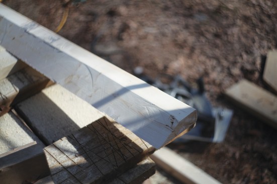

The swing table allows the Big Foot saw to make acute beveled crosscuts.

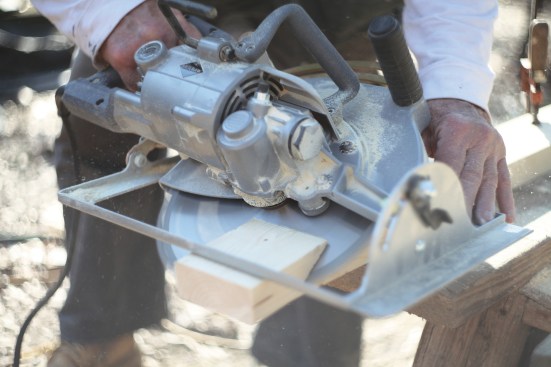

Here, the author used the swing table-equipped saw to make the 63 1/2-degree cut needed to frame this gable-end wall.
