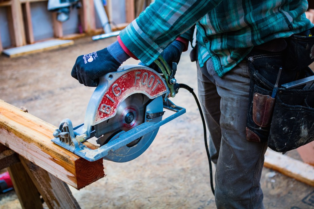

In late 2014, Skilsaw released a 10 ¼-inch beam saw called the Sawsquatch. I was excited to try this saw out because this was a saw designed to spin a larger blade, unlike the Big Foot saws we had been using for years. Those saws took Bosch or Skil bodies and adapted the guards to use larger blades. I wrote about our experience with the Sawsquatch and concluded the review by saying, “if I was buying now, I’d save up and get a Sawsquatch.” Recently, Big Foot redesigned its saw (SC-1025SU) with some improvements to compete with the Sawsquatch. Big Foot gave us one to try out; we’ve been using it for the past several months.

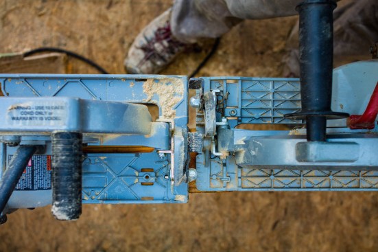

Another difference is that the left side of the baseplate is ½ inch bigger than the Sawsquatch. A standard baseplate is 1-1/2 inches wide off the blade, but Big Foot is 2-1/2 inches. This means for me that you can cut at the very end of a beam (working on the right-hand side) and keep the saw stable. Is this a huge improvement? No, but it is an improvement we like. These are big saws and a larger baseplate is nice, especially when we are cutting exposed beams.
The baseplate on the Big Foot (left) is ½” larger than the one on the Sawsquatch (right). Standard base plates run 1 ½” wide off the blade, but the Big Foot runs 2-1/2” which gives the saw more stability when cutting at the end of a beam (when working on the right hand side).

Using the two saws head to head, I found the Big Foot to be slightly more comfortable to use than the Sawsquatch. It is a little lighter and very well balanced. We use it for a lot of repetitive cutting like gang-cutting blocking, and balance plays a big role with jobs like that.
I can’t say anything negative about the Sawsquatch because it is a good saw and has been now for nearly two years. We keep both of these saws in the Sprinter, but the Big Foot is the one that comes out most often.

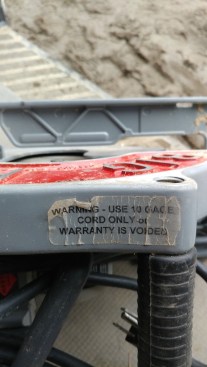

We haven’t had anything negative come up with the saw, and we use it nearly every day. I firmly believe every framing crew needs at least one beam saw to be productive; this is the saw I recommend buying. One note though: You have to use a heavier gauge extension cord. To keep the Big Foot warranty intact, you have to use a 10-gauge cord at a maximum length of 50 feet. While the saw will run on a 100-foot 12-gauge plugged into a spider box for most applications, doing so will void the warranty and isn’t recommended by Big Foot. If we know we’ll be doing any ripping, we use the 10-gauge cord straight from the power pole.
Big Foot wants to make it clear what size extension cord to use. They also said not to go over 50'.
