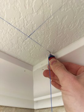

Line. The Shinwa Neo has a much thinner line than other brands do, measuring only 0.020 inch thick. Even so, it can span distances up to 50 feet, suitable for even my longest length projects. The thin line is great for trim projects with tight tolerances, such as coffered ceilings, compared with the thicker lines left by most other chalk boxes. Those bold lines can measure up to 1/8 inch thick, more suitable for framing carpenters who need to mark rough surfaces.

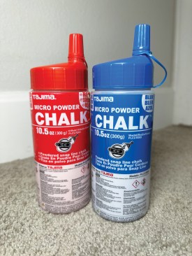

To fill his Shinwa Neo chalk box, the author uses Tajima’s micro powder chalk, which is specially formulated to produce fine lines.
For consistent lines and full functionality of the chalk box, I use Tajima’s micro powder chalk. It comes in a variety of colors, such as blue and red, which is useful for projects that need multiple lines of reference.

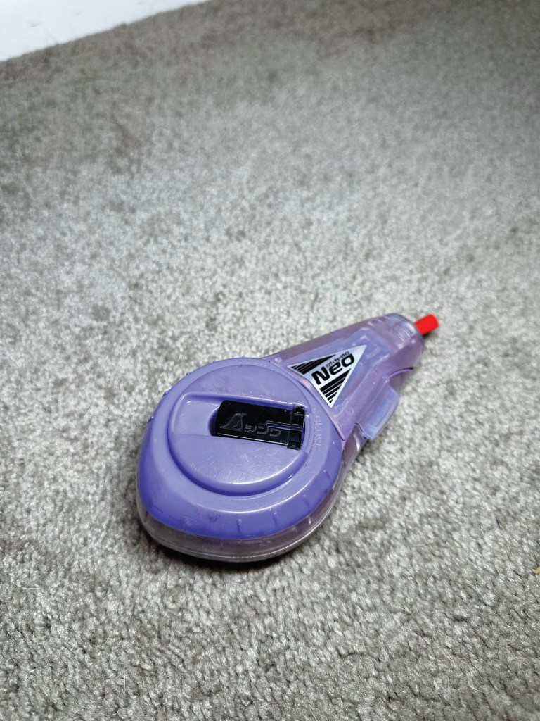

With a low gear ratio and folding crank handle, manually retrieving the line is simple and fast. Once the line is secured, the quick flip handle sits flush inside of the body to ensure zero interference when you’re slipping the chalk box back into your tool pouch.

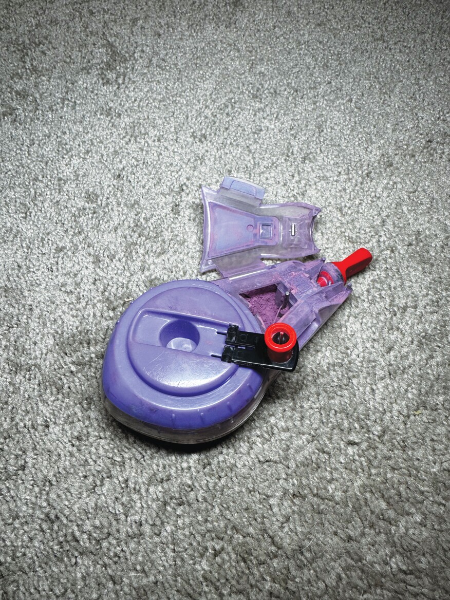

The Shinwa Neo chalk box has a rugged ABS case with a folding crank handle and a thin braided line for snapping fine chalk lines.
Body. Weighing in at 5.3 ounces, the body is made from a tough ABS resin that has held up to numerous typical falls off scaffolding and ladders, so durability has not been a concern. The transparent body offers quick viewing of the amount of chalk left inside, with an easily operated access door for quick refills. I especially like the way that this design doesn’t interfere with the line like typical top-threaded chalk boxes. Once the door is closed, the body is sealed to prevent powder from leaking and humidity from entering.

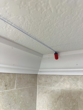

Hooks. The Shinwa Neo offers two attachment options. There is a standard hook—the type that is commonly seen on most chalk boxes—that can be used for metal and concrete parts. There is also a pin receiver (a sharp needle with plastic housing for easy insertion) that solves one of my biggest gripes about snapping lines: having to place a nail or screw into the wall to attach the chalk line. The pin receiver, which works well on both wood and drywall, makes my life easier and is the feature that makes this chalk box stand out from other ultra-thin-line chalk boxes. Once the line is snapped, only a pin-sized hole is left, making this the least intrusive option when snapping lines by yourself on those types of surfaces.
The Shinwa Neo chalk box comes with both a regular hook and a pin receiver with a thin needle that can be inserted into drywall or wood trim.
The pin receiver is well suited for solo work, and leaves a tiny unobtrusive hole.
