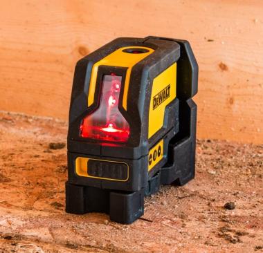

The DW0822 is a combination laser, meaning it is both a line laser and a dot laser. There is a vertical line, a horizontal line, and dots (or points) that go up and down like a plumb bob.

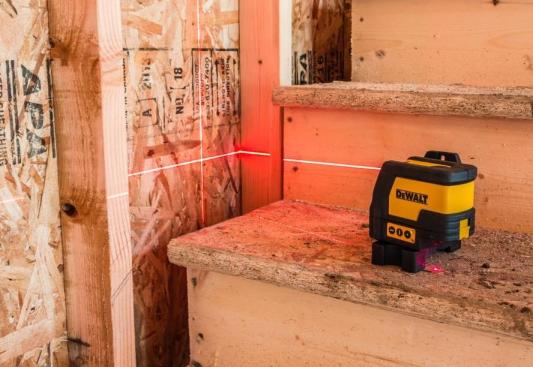

We use this tool in place of a plumb bob so the dots are the number one feature for us. Most of the time we set the laser on the ground over a layout line and then carry it up to the ceiling or underside of a rafter. Other times we might set it on top of a beam and transfer layout to the floor.

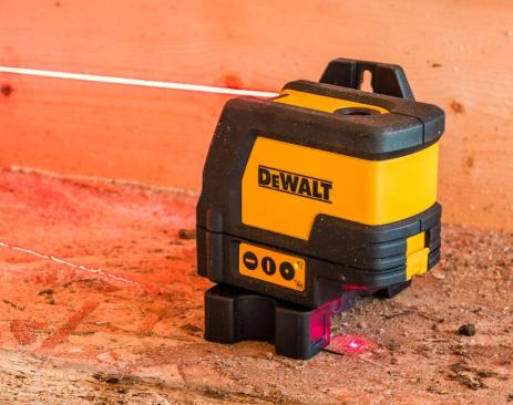

The laser also generates a horizontal and a vertical line with a beam spread of nearly 180 degrees. We rarely use the vertical line but we often shoot level while setting windows and establishing grades for stair platforms and porches. The lines are pulsed, so if you have a detector you will be able to pick up the lines when they’re too faint to be seen in bright sunlight.

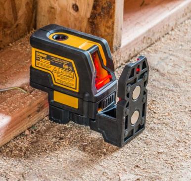

An integrated base raises the tool up; if you swivel it sideways there will be enough distance between the tool and the floor for you to see the down dot without having to get on your hands and knees. The housing has an offset so you can set it next to a bottom plate and plumb up to the top plate above.
The base also has two very strong magnets that allow you to stick the tool to something metal. This probably isn’t the best method, but we found that two 16d sinkers in the wall provide just enough metal to hang the laser. A metal stud would be perfect. What the magnets mean for us as framers is we don’t need a tripod to set windows; we can put a piece of metal on a wall at about the height we want and then move the laser up and down.
