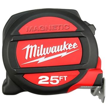

This summer Milwaukee announced a new line of tape measures and I asked them to send one for testing. They sent the 25-foot magnetic model (48-22-5125). I’ve been using it for a couple of months and am impressed by its durability and features.
Milwaukee says they’ve run this tape (another one, not mine) through a drop test, and it stood up to as many as 200 impacts from a height of 10-feet. I’ve dropped mine from 8-feet onto concrete a few times, and it still works perfectly.

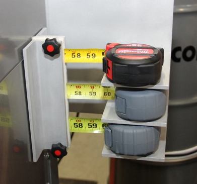

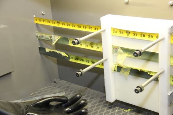

According to the manufacturer, the blade is made with a nylon bond technology that makes it more resistant to grit than other tapes. To prove how durable the markings are Milwaukee performs a demonstration (which I saw at a media event) that shows its blade being sandblasted alongside two competitors’ blades. It takes only a few seconds to clean the number off the competitors’ blades. Sandblasting cause minimal damage to the Milwaukee’s blade; after 30 seconds it looked almost new.

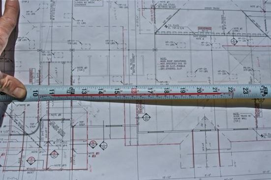

What I like best about the Milwaukee tape is the 12-inch architectural scale on the back of the blade. I’m good at scaling drawings in the field with a tape measure, counting out eighths and quarters to get a dimension, but it’s easier to do with an architectural scale. The scale is one of those, “Gee, why doesn’t everybody do it,” ideas.

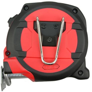

To reduce wear on pockets and tool belts the belt clip is a wire bale instead of a flat piece of metal. It does a good job holding the tape in place; there’s nothing worse than climbing to take a measurement and then realizing your tape fell to the ground.
