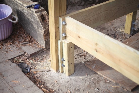

Accuracy. The Rockler drill guide does just that. On a recent project, I needed to drill a pair of 5/8-inch-diameter holes horizontally for galvanized bolts that would serve a structural function. The 6-inch-long bolts had to run straight through a 4×4 post and a 2×10 ledger with a small margin for error; if I veered off-center, either I would miss the end of the piece I was attaching, or I would end up in the end of a ledger coming from the other direction. So I used the drill guide as I bored these holes. I started by using a long 1/4-inch bit to drill a pilot hole, then switched to a 5/8-inch-diameter bit to finish this boring task. The results were excellent.
To accurately drill 5/8-inch-diameter holes through this 4×4 post and 2×10 rim joist assembly, the author started by drilling drilling 1/4-inch-diameter pilot holes. Then he switched to a 5/8-inch-diameter bit to finish the holes.
