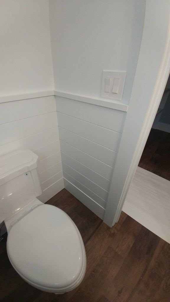

When using shiplap as a wainscoting, make sure to consider device heights and how the switchplates will intersect with the shiplap or whatever top cap assembly you use.

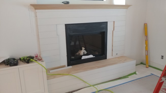

Once you have termination points laid out and the type (dado, butt, return) laid out, it’s a matter of nailing it to the wall. Almost. First, avoid slivers.
You don’t want to start running the shiplap and end up with a sliver at the top, or worse, a tapered sliver. So, a little math goes a long way. I love the Construction Master Pro app on my phone. I use it on almost every project. Just measure the wall height in a few places, measure the shiplap reveal, then divide to see how the pieces land. You can divide the border piece in half—like tile or a suspended ceiling with even pieces on each end—or put the whole border piece on one end. Sometimes it looks better to have the border piece at the bottom, sometimes at the top. It’s personal preference.
Once I figure out the width of the bottom piece, I like to run my laser along the room and make horizontal reference marks. Then you can get that bottom piece level—or parallel with the ceiling, whichever works better—and nailed on. I use an 18-gauge brad nailer for this and for most of my trim. I face-nail the bottom, then into the tongue. On nickel gap, you have to nail a little higher in the tongue so you don’t see the nails in the gap. On tight gap, you have to face-nail it, as there is no tongue. Using tight gap, you could run from the top down, but usually I run it bottom up and we put a trim piece to close the gap at the top, usually a crown or flat stop.
Whether you are working on a fireplace or full wall, slivers must be addressed before installation. I use the Construction Master Pro app on my phone to figure out where the skinny piece will be and how big it is, and that determines how I address it.
