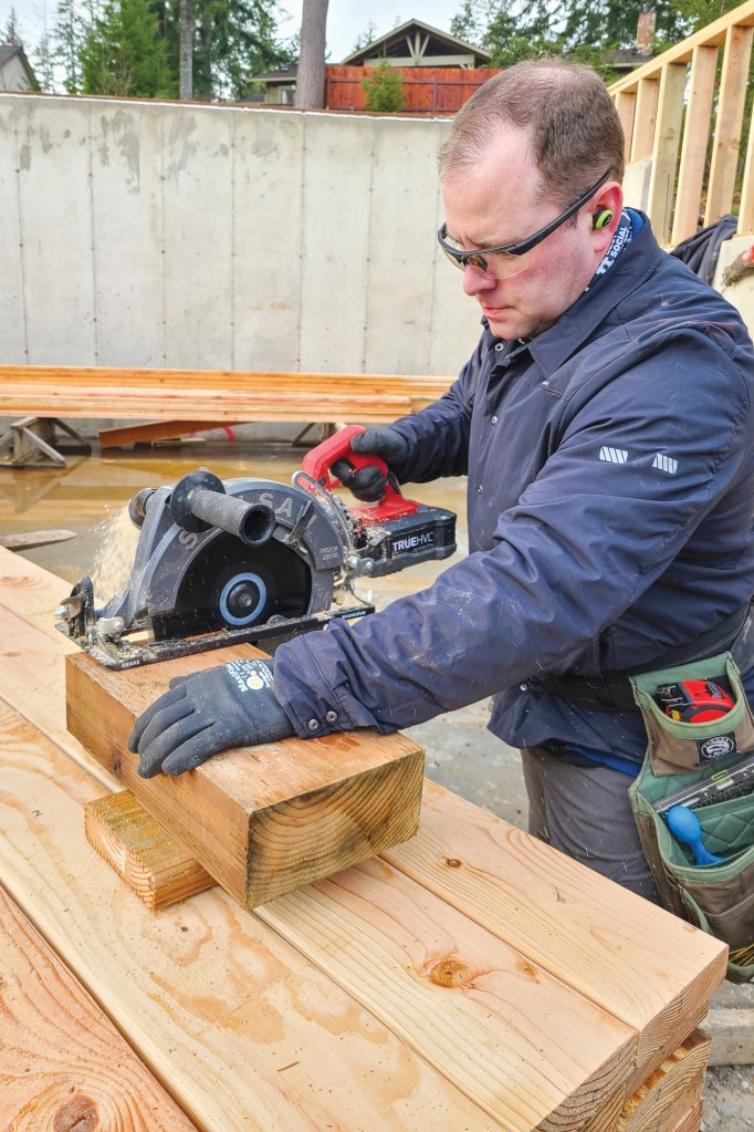

Until recently, the last power tool that we’ve had to plug into a 110V outlet was one of our 10 1/4-inch beam saws, which see quite a bit of use on our framing jobs. Besides being useful for cutting headers, beam saws allow me to cut my wall plates two at a time so that they are identical, though I’ve had to put that practice on hold as we’ve moved more and more toward cordless tools. But now, with the introduction of Skilsaw’s new Truehvl 10 1/4-inch worm drive saw, we are 100% cordless with power tools and quickly cutting double plates again.

This is a true 10 1/4-inch wormdrive saw, designed from the ground up for a larger blade, with no need to be adapted with an add-on kit. For example, the blade brake—a must-have feature on any saw, but especially on one with a larger blade—works flawlessly. With a depth of cut of 3 11/16 inches, the saw can easily cut through a 4×4 in a single pass, and it’s a great saw to cut I-joists that are too wide for a 7 1/4-inch saw. It can also cut bevels to 51 degrees.
My kit shipped with only one battery. For me, this isn’t a problem, as I don’t cut as much lumber using a saw like this as I do with a standard 7 1/4-inch saw; in fact, I haven’t managed to drain the battery yet in the few weeks or so that we’ve had the saw on our jobsites. I don’t think I’ll ever have a problem, since I can throw the battery on the charger at lunch, basically guaranteeing I’ll never run out of juice.

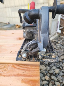

The blade-left saw, which has an electric brake and a built-in dust port, can be tilted to make bevel cuts of up to 51 degrees.
Though the saw weighs close to 20 pounds, it doesn’t feel unwieldy or heavy on my wrist. With the big battery attached under the rear handle, it is very well-balanced.
The upper guard is equipped with a dust port, which discharges most of the sawdust during a cut. I probably wouldn’t ever feel the need to use dust collection with this saw, but not having sawdust all over my cutting area is not a bad thing. Even without a vacuum hooked up to the saw, most of the dust is directed out of the dust port and off to the side.

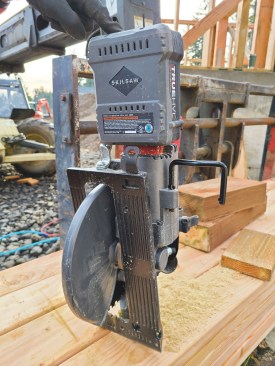

The saw comes with a rafter hook, which works fine on joists, though it took a little head-scratching to figure out how to get it to play nice with our sawhorses. Basically, the battery hanging off the back of the saw tends to get in the way, but it’s not an issue worth griping about.
The beam saw also features a rafter hook, which the author found works fine on rafters, but not so much on sawhorses.
