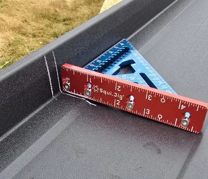

Set screws in the heel allow easy offset adjustment to different four options. This allows the user to tailor the square to what they need for the task at hand.
The heel can be adjusted in several ways:
  • Centered or removed entirely
  • Offset ¼ inch on one side and ½ inch on the other
  • Offset ⅛ inch and ⅝ inch—a most useful combination

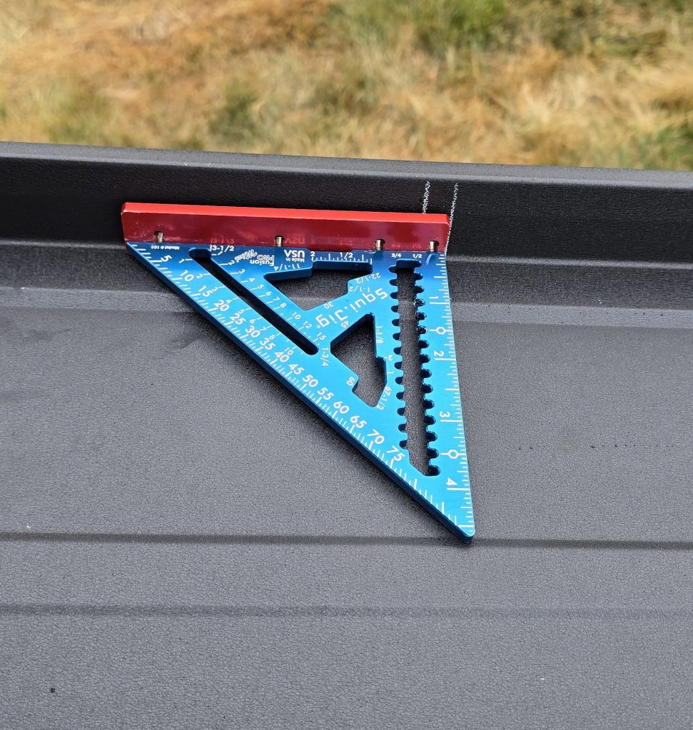

That ⅛-inch offset is the real gem. It allows the square to sit almost perfectly flat, which improves layout accuracy by helping to prevent your pencil from wandering underneath the blade. At the same time, the ⅛-inch heel still registers cleanly against a hemmed metal edge, giving you a positive reference point even on thin stock.
Aron Jones
By having the heel flush to one side the user can make scribe lines on an inside corners.
