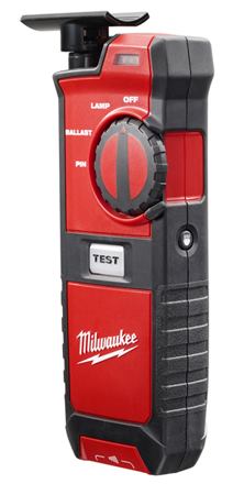

    So what is this tool and why is it such a big deal? It’s a Fluorescent Lighting Tester (2210-20) that allows an electrician or maintenance person to use a single detection device to figure out why a particular fixture or bulb isn’t working – without ever leaving the ground. That may not mean much to those of us who have a few fluorescent fixtures in the shop or kitchen – but it does to the facilities guy who is responsible for the lights in an office building or school. If the building is large enough, he and a helper could work full-time changing bulbs and ballasts and never complete the job.
    And you know how it is with fluorescents – you think it’s the bulb, so you change it, and then find out that the bulb was fine and the ballast is shot.
    The lighting tester is a simple to operate: set the dial to the item you want to test, extend the telescoping antenna, and touch the probe to the bulb. The tester will beep or a diode will flash to indicate the problem. If the ballast is bad you won’t waste time climbing a ladder and removing a diffuser so you can change a bulb that still works. With this tool you can quickly check all of the nonfunctioning lights in an area and know how many bulbs and ballasts to bring when it’s time to do the work.
    The Fluorescent Lighting Tester has a suggested retail price of $199 and should be hitting store shelves in February.
    Specifications:
    2210-20 Fluorescent Lighting Tester
    Test all T5, T8, T12 fluorescent lamps
  • Optimized for T8 electronic ballasts
  • Check pin connections on all T5, T8, T12 lamps
  • Includes 2210-20 Fluorescent Lighting Tester, Adapter, 4 AA Batteries, Manual and Carrying Case.
