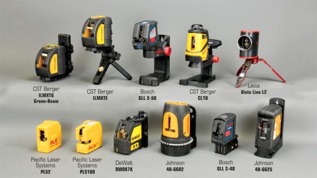

For this article, my crew and I tested 11 self-leveling line lasers that can be purchased for $300 or less – an amount any tradesperson should be willing to spend for a tool that can pay for itself. Our pricing came from reputable online dealers; you may pay more or less based on when and where you buy the tool. We chose not to include point-to-point (dot) lasers, mostly because they’re not as applicable to the tasks contractors perform every day.

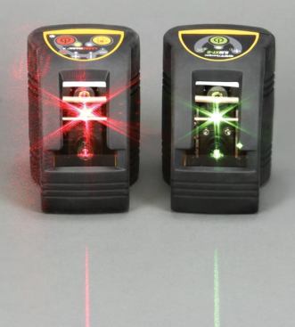

Laser beams are either red or green. Red is more common because red diodes cost less, use less power, and will continue to work at lower temperatures. But green is more easily picked up by the human eye, so some lasers – usually expensive rotary models – use that color. All but one of the tools we tested project red beams. The exception is CST Berger’s ILMXTG, which is the only green-beam laser in this price range.

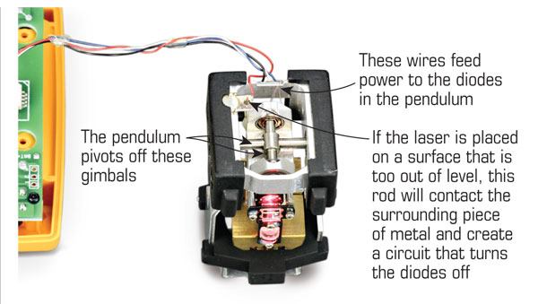

Modern line lasers are self-leveling, and the vast majority rely on pendulums to bring their beams to level. The diodes are attached to the pendulum, which swings on a pair of gimbals. When the pendulum comes to rest, the projected beams will be plumb and level.
The pendulum only works within a limited range; if the base of the laser is not within 4 to 6 degrees of level, the tool will be unable to level itself. When this happens, the laser will alert the user by sounding a beeper, rapidly flashing the beams, or shutting the beams down. If the laser has an indicator lamp, it will flash or shine red.

Though green beams are said to be easier to see than red ones, green-beam lasers are costlier, burn through batteries more quickly, and may fail to work in very cold weather.

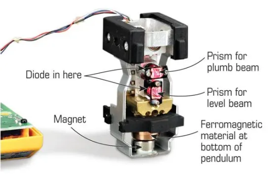

The author removed the housing from this PLS2 to show how line lasers work. The diodes are attached to a pendulum that swings from a set of gimbals. A magnet dampens the swinging motion of the pendulum and helps it come to level more quickly.

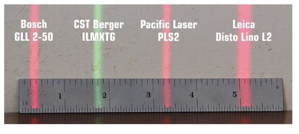

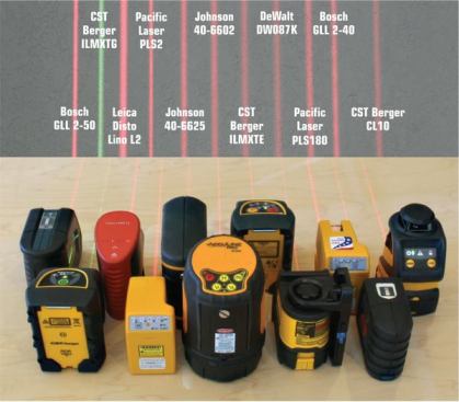

This is what the beams look like when the tools are lined up and their vertical beams are projected 55 feet onto a textured plaster wall. The first four beams on the left are brighter and crisper than the rest.
At 55 feet, most of the beams have spread to about 1/8 inch wide. These are the four brightest beams at that distance. Note how the beam from the Leica has spread to about 1/4 inch wide.
