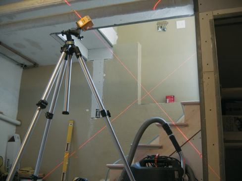

Every tool in the test can project sloped lines, which are handy for laying out stair rails, angled tile, and anything else that must be straight but not plumb or level.
Credit: Chris Kennel

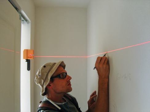

A line laser’s beams are designed to fan out at the widest possible angle. Though it varies by model, this angle is typically about 160 degrees for the vertical line and 130 degrees for the horizontal. If the fan angle is narrow and the vertical beam points straight forward (instead of forward and slightly up), you may have trouble sending a line to the top of a wall. You can usually fix this problem by positioning the tool farther back from the wall, but sometimes the room is too narrow, or the laser ends up being in your way.
Four of the tools we tested have such good vertical beam spread that they can be placed in contact with the wall and their lines will carry up the wall and some distance out onto the ceiling. The beams from the Bosch GLL 2-50 and the ILMXTE will come about 12 inches out onto an 8-foot ceiling, while those from the PLS180 and the DW087K will come several feet out.
The PLS180 projects a particularly wide horizontal beam and is being used here to lay out shelf cleats in a closet. It's supported by a magnetic bracket that's stuck to the metal corner bead.
The fan angle is less of an issue with the horizontal beam, because it’s easy enough to pivot the laser and put the line onto another part of the wall, or place the tool close to the wall and project a line down the length of it. Two models stand out for their horizontal coverage: The CL10 projects a 360-degree line, and the PLS180 projects a full 180 degrees.

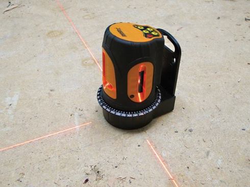

The Johnson 40-6602 has three vertical beams - two more than the other lasers tested. In addition to projecting plumb and level lines onto walls, it can project square layout onto the floor.
The Johnson 40-6602 has three vertical beams – two more than the other lasers tested. In addition to projecting plumb and level lines onto walls, it can project square layout onto the floor.
Johnson’s 40-6602 stands out for a different reason: It has three vertical beams instead of the usual one. One comes out the front and the others come out the side. These lines are perpendicular to each other, so the tool can project square layout across the floor and carry it vertically up the walls.

I also like the Johnson 40-6602, even though it’s bigger and heavier than the other models tested. With three vertical beams (instead of the usual one), it can project square floor layout that extends up the walls and onto the ceiling above. There are other lasers that can do that, but they cost more than this one does.
