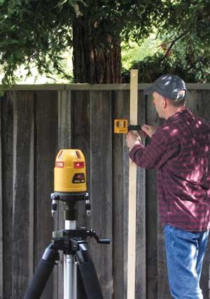

The range of these tools is listed in the spec tables. When used indoors, the range is highly dependent on the ambient lighting conditions: The brighter the surroundings, the harder it will be to see the line. Past a certain point, the line won’t be visible to the naked eye – and then you’ll have to use a target card, laser glasses, or a receiver to locate it. I find that I rarely need to use receivers indoors, because the lighting is dim and the distances are short enough to make out the beam. But outdoors, and especially over greater distances, the only way to detect the beam is with a receiver, which produces an audible beep or displays an icon on the screen to indicate that a beam is hitting it.
Receivers work only with models equipped with a pulse function. When the laser is set to pulse, the beam flicks on and off very rapidly – so rapidly it can only be detected by the receiver. In my experience, receivers are interchangeable within brands and usually between brands. This was the case with all but three of the tools we tested: The Agatec and Topcon LC-2 work with a receiver that doesn’t work with other lasers, and the Bosch did not work with any of the receivers we had – though it does work with one from Bosch. If you need a receiver, it will be less expensive to buy it as part of the kit than to purchase it separately.
