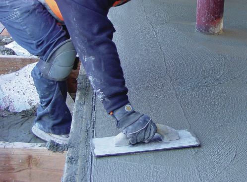

Wood and magnesium floats
While hand floats are primarily available in wood and magnesium, the most popular are made of magnesium. This is because magnesium floats are extremely durable and easily slide across the surface. Wood floats are rougher and typically limited to floating non-air-entrained and high-slump concretes. (Always use non-air-entrained concrete for troweled floors. Air-entrainment significantly increases the risk of trapping escaping air bubbles below the top surface, which leads to blisters and delaminations.)
Both float types are available with surfaces 3 to 4 inches wide and 12 to 20 inches long. The purpose of floating with an actual float is to embed the coarse aggregate particles, remove surface imperfections such as ridges from bull floating, create a smooth surface, and bring some mortar to the surface. Floating also cuts down high spots and fills holes as well as reestablishes the moisture in the surface mortar that was lost to evaporation.

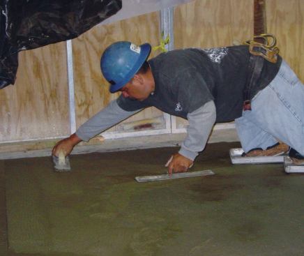

Always float the surface before finishing with a trowel or fresno. Start floating after the bleedwater sheen has disappeared and a finisher using kneeboards has left no more than about a 1/8-inch indentation. Trapping bleedwater beneath the top surface, or finishing bleedwater into the surface, can cause delaminations or dusting.
While floating with either a wood or magnesium float, do not tilt the float. Keep the blade as flat as possible or in full contact with the surface of the concrete to avoid densifying and sealing the surface. To avoid blisters and delaminations, the surface must be kept “open” so bleedwater and entrapped air can escape. Increasing the blade angle will reduce the contact area between the blade and concrete, which increases the blade pressure. Too much pressure can seal the surface by compacting and densifying the mortar along the surface.

7. Float to embed the coarse aggregate particles, remove surface imperfections, and create a smooth surface. Use a wood or magnesium float and don’t seal the surface.
8. Trowel to create a smooth, hard surface. Use a steel or fresno trowel, depending on the desired surface hardness.

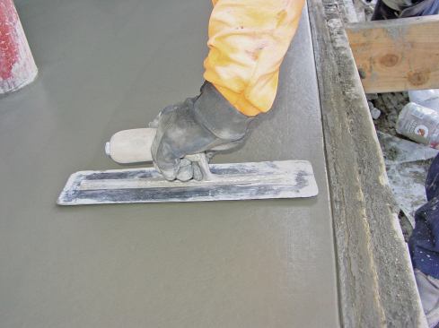

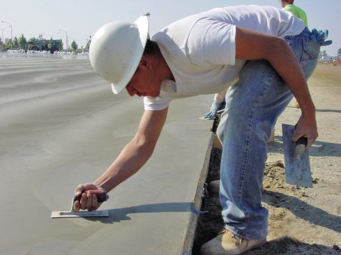

Troweling is done in the final stages of finishing and only after the surface has been floated. Troweling makes the surface hard and dense. Hand finishing trowels should be made of steel, usually 3 to 5 inches wide and 10 to 20 inches long. Use large sizes for the first troweling to spread the blade pressure over a large area, which minimizes the risk of prematurely sealing the surface. Keep the trowel blade as flat as possible.
As the surface becomes harder, perform subsequent trowelings with smaller trowels (in width and length). Also, progressively increase the tilt angle of the trowel blade to increase blade pressure. Increasing the blade pressure compacts and densifies the surface mortar to create a smooth, hard, and more wear-resistant surface.
