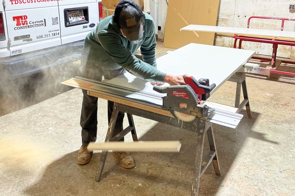

Speaking of sawdust, Milwaukee claims 90% dust recovery when the matching dust bag or a dust extractor is used. In practice, we found this claim seemed about right, though—as with most track saws—the large hole in the side shroud of the saw that is necessary for the removal of the blade allows some dust to escape and has a dulling effect on the strength of a dust extractor.

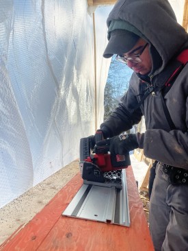

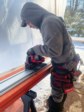

The author found that the saw has the finesse to trim doors and the power and cutting capacity to slice through framing stock and engineered lumber.
Performance. Cutting with the Milwaukee M18 track saw, as with most of the track saws on the market, is a joy. The brushless motor on the saw has plenty of power cutting and ripping all framing materials and doing light surgical demo work—one of our carpenters used the saw to make a straight line cut in a roof deck that allowed us to tie a new addition roof in while giving the roofer a clean line to patch to. Using a wheel-style speed selector, the brushless motor can be set to produce 2,500 to 5,800 rpm with a max of 6,300 rpm under load. The saw has shown it has plenty of power for all the framing applications that we’ve put it through and plenty of finesse for the standard track-saw application of cutting finish-grade sheet goods and trimming interior doors.
