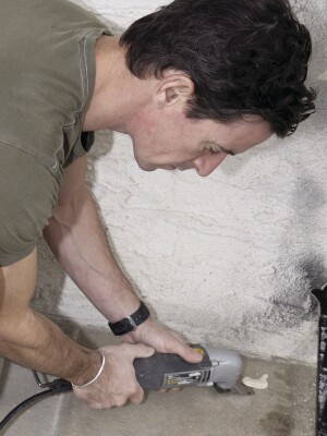

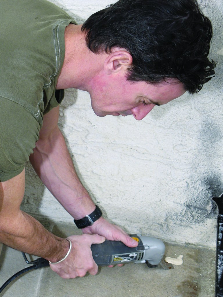

Anywhere there’s paint or glue, this tool is a time and sanity saver. I used it on urethane adhesive that oozed out of an assembly and onto a concrete slab, and the scraper blade took up the dried gob wholesale — quicker, easier, and cleaner than with a 5-in-1 tool.
