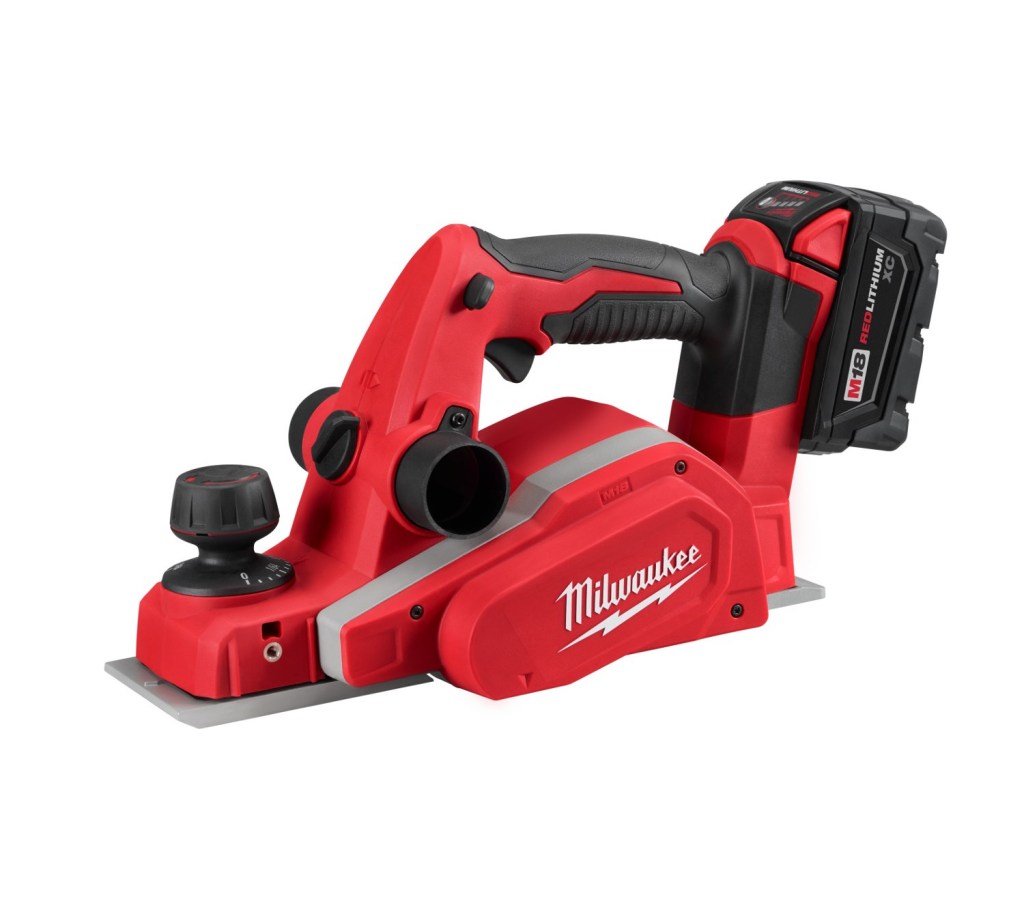

In June I attended a Milwaukee media event and one of the more interesting tools there was a 3 1/4-inch cordless power planer (2623). It was as interesting for what it represents—the first new “woodworking” tool from the company in a decade—as for the well-designed planer it appears to be.
Features include 20 indexed cut settings and a maximum depth-of-cut of 27/64 inches, which comes to 1/256 inch per click. The maximum rabbet depth is 27/64 inches, which Milwaukee says is “best in class”. The tool takes a pair of double-edged carbide blades and spins at 14,000 rpm. It will be available bare or in a one-battery kit that includes an edge bevel guide.

M18 Planer Specs
Power: 18-volt M18 battery
Blades: two 3 1/4-inch double-sided carbide
Speed: 14,000 rpm
Depth settings: 20 in increments of 1/256”
Max depth of cut: 27/64”
Max rabbet: 27/64”
Weight: 7.5 pounds (with battery)
COO: China
Kit version (2623-21) includes: planer, two blades, charger, one XC battery, bevel edge guide, contractors bag; also available bare (2623-20)
