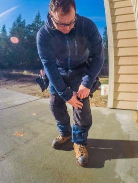

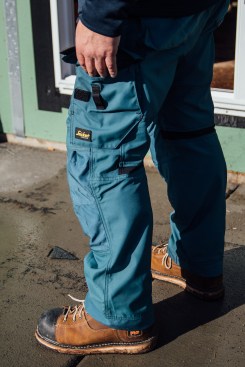

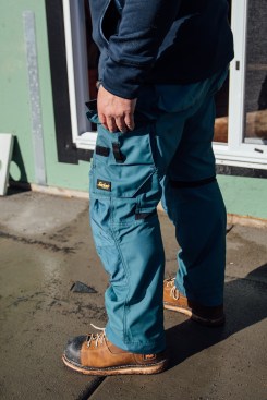

AllroundWork Trouser. Snickers has a variety of trouser and short options for tradesmen and tradeswomen, with everything from high visibility and built-in outside pockets available. I opted for the AllroundWork Trousers, which don’t have outside pockets. As a framer, I have to wear tool bags, so pants with built-in pockets tend to get in the way. This pant is a little slimmer cut than American pants, but has a Cordura stretch crotch gusset (which is the most common wear point in pants). Behind the knees are openings to allow for ventilation. The Cordura-reinforced knees allow for kneepads to be inserted from the outside.
I found these to be very comfortable pants, similar to the Bjornklader Jubilee I reviewed last year, though I think the Snickers are a little more comfortable.
What sets Snickers apart from other brands is that the company has a much larger selection of sizes. I highly recommend these pants, but know that they are a little slimmer so if you have larger legs (like I do), then they’ll be a little snug. You can buy them from Snickersdirect.com for about $80. I opted for the “petrol” color and love them.

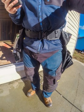

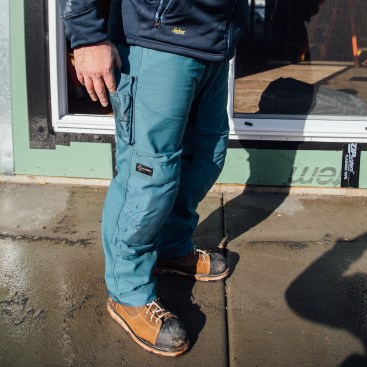

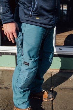

FlexiWork. This pant was recommended to me because it is made to be flexible. The fabric is a lightweight (similar to the G2) “Cordura stretch and rip-stop fabric.” Like the Allround, the FlexiWork has ventilating knees and kneepad pockets that insert from the outside.
The pant comes with a built-in belt. I love the belt because it doesn’t get in the way of the buckle on my tool belt. This pant is so comfortable to wear that I have to recommend it. I feel like this pant (and the G2 above) are the tradie’s (I learned a new Australian word from some carpenters on IG from Australia) equivalent of Lululemon yoga pants. At $100, they are a steal. I have been working in them in upper 20°F temps and thermals and have been plenty warm.
I had a guy at the grocery store ask me about them. He was interested in buying them because of the built-in kneepad pockets for his job stocking shelves.
One thing I wish is that the color selection was better. I’d like a lighter color to wear when we get closer to warm temps in a few months because I’m anticipating these absorbing the sun and getting warm.
