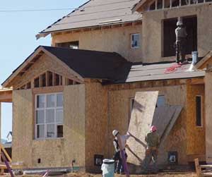

Walk around any jobsite on any given day–even the ones with well-trained and experienced work crews–and you are likely to see some relatively unsafe setup or dangerous situation waiting for trouble. Workers who know better will overlook safety because they think “I’m just going onto the roof for a couple of minutes” or “I’ve just got to make this one cut” or “we’ll have this framed in right after lunch–so let’s leave it open.” Then, during lunch, it starts raining hard and everyone rushes to get their tools into the trailer and head home, leaving an unguarded stair opening or uncovered chimney hole waiting for somebody else to step through it.
Think again. Develop an eye for safety on your site–and a team approach to looking out for each other. Make safety a team sport, because this is a game you play and need to win–every day.

Look up. Look up onto staging, roofing, ladders, and upper floors for tools, materials, and anything else that could hurt you if it fell your way. Before you work under another work area, make sure workers above you know you will be below them.
Look down. Look down to see if anyone is working below you and let them know you are there–and that you know they are working below. Use every precaution to keep tools, materials, and yourself from falling with secure work stations for tool storage, proper stacking and securing of materials, and use of fall-protection and fall-arrest harnesses where required.
