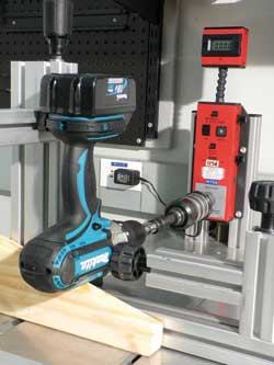

That was the general idea when the manufacturer members of the Power Tool Institute met in an open forum back in 2005 to discuss formulating voluntary industry procedures . The first two proposed were test lab procedures for determining relative torque for corded and cordless drills, drill/drivers, and screwdrivers, and a procedure for determining power-tool horsepower. As noted above, these measurement procedures were enacted by PTI early last year.

According to several manufacturers, the horsepower test procedure is a fairly straightforward, easy-to-apply measurement that was quickly adopted by most brands. The torque procedure, however, has become a contentious issue among the industry players. Although all of the PTI members shaped it, voted it into creation, and agreed to abide by it, the majority of manufacturers have yet to implement it.
To date, only two of the 13 brands affected– Hilti and Makita– are testing and publishing torque data for their drill- and driver-category tools based on the PTI specifications. The other manufacturers continue to test and promote their own versions of power measurement. Although most of the noncompliant toolmakers claim to support and even admire the PTI effort, they have not indicated that they will comply with the voluntary procedures anytime soon. Some of these manufacturers are simply taking a wait-and-see approach, watching to find out what their competitors will do before deciding their course of action.
