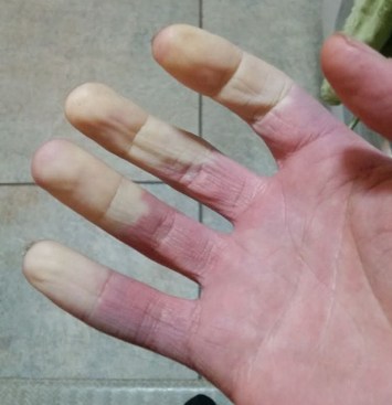

Blanching of the skin is the start of frostnip. The skin will feel numb and waxy to the touch.

My experience with frostnip or frostbite is affected by the fact that I have Raynaud’s. This is a condition in which circulation to the extremities is already poor. In my case, it affects my hands the most, and years of working in the cold have made me even more sensitive to it. Repeated damage has resulted in permanent numbness and lack of sensitivity. So, take care of those hands and toes—you only get one set.
