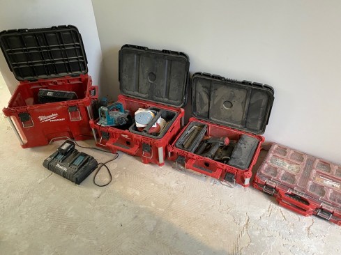

In the past decade, tool companies including DeWalt, Festool, Makita, Milwaukee, Ridgid, and others have introduced stackable tool-storage systems that are now found on many a jobsite. I own a number of these, but I’ve become wary of their limitations. Commercially made systems work well for moving tools and fasteners on and off the jobsite, and they can be convenient storage solutions in a truck or shop. But on the job, they need to be spread out for what’s inside each one to be accessible, and I end up stooping or kneeling much more than I want to in order to get to the contents of the boxes.
Perhaps the biggest drawback to these commercially made systems is that it’s in the manufacturer’s best interest to sell you as many of them as possible, and they often include blow-molded plastic inserts that waste an enormous amount of space in each box. I love most of my Festool tools, but I don’t want to carry an entire Systainer just for one screw gun and then a separate Systainer for an impact driver. These are not fragile tools, and it often makes more sense to ditch the inserts and pack several similar tools and their accessories in the same box.

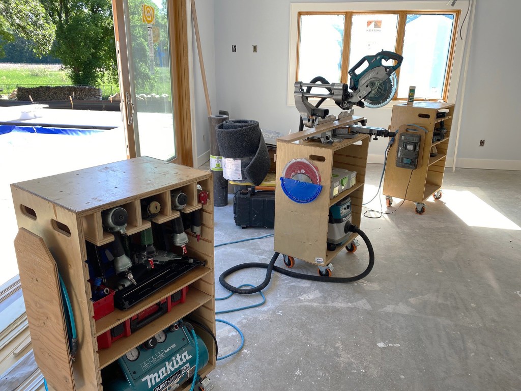

Portable shop. On large trim jobs, the author rolls out tool cases that double as a miter saw stand—a shorter case (center) for the saw and taller cases that function as material supports. The cases organize tools by category: pneumatic tools like air guns and a compressor (at left); cordless tools and chargers (at right).

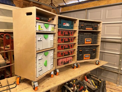

The rolling cases shown in the photos at left and on the opposite page mark the beginning of my quest to make more efficient use of toolbox systems. It started with a rolling cart I made to support my miter saw—the center of my on-site shop setup for interior trim jobs. I then developed three other rolling carts that were tall enough to also function as supports for long material on either side of the saw cart. I organized each cart around particular tool types—cordless tools, pneumatic tools, and common corded tools—and included the necessary accessories for each: batteries and chargers on the cordless-tool cart; compressor, hoses, and fasteners on the pneumatic cart; and an outlet hub and extension cords, as well as blades and bits, on the corded tool cart.
I designed each cart to accommodate the various brand-name toolboxes I owned so I could get at the contents easily by sliding the containers in and out of shelves rather than locking them all together.
To minimize wasted space around the boxes, I built carts of different widths, but the sides all have the same shelf increments, which I made by cutting evenly spaced dadoes using the table-saw sled described in my last JLC article, “Carpentry Jigs to Speed Production” (Sep/Oct/23). After the first dado is cut, I set that dado over the cleat on the sled to produce subsequent dadoes on 3-inch centers for the shelves. I landed on that increment after experimenting with Tanos/Festool and Makita boxes and the Ridgid and Milwaukee small-parts organizers I had. It allows me to vary the shelf spacing to accommodate any of these boxes with minimal wasted space above them.

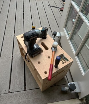

Flexible. I am called to do all kinds of jobs. It makes sense to bring in my rolling cases for a major trim job that lasts a week or more, but they’re more than I need for small jobs and pick-up work that might take me a couple of hours or less. Smaller jobs call for the lightweight workstation shown at left, which I can set up and take down quickly at the beginning and end of each day.

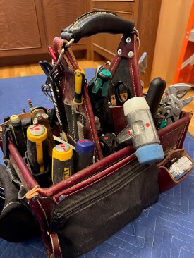

To remain flexible, it’s important to have some “empty capacity.” I keep a few empty tool bags, totes, or buckets on hand so I can pull together a basic setup for a given task by tossing in the specific tools and supplies needed for it.

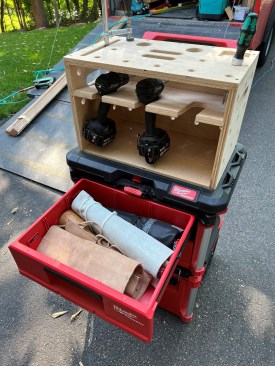

I also like tool organizers that can do double-duty as a work surface. Toward this end, the tops of my rolling carts are drilled out for bench dogs and cutouts that I can use for clamping or mounting a router for a ready-made router table. My smaller tool totes may be heavier than a plastic box, but they serve well as step stools, which often saves me an extra trip to the truck for a stepladder.

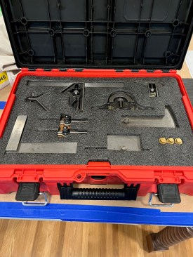

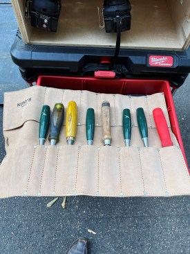

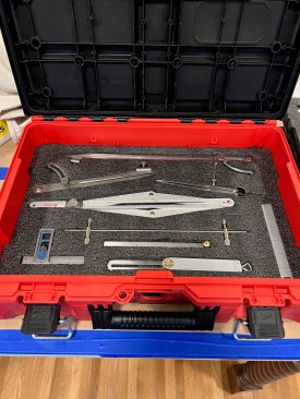

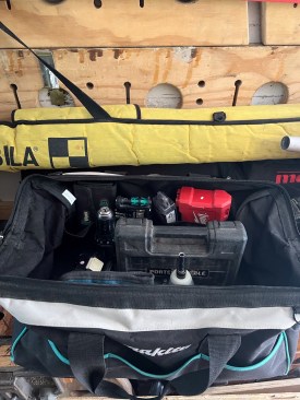

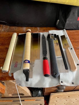

Don’t carry air. Don’t hesitate to ditch or modify the blow-modeled inserts that come with toolboxes for specific new tools. Think small, tight packages that can be grabbed out of a drawer or toolbox. Tool rolls, one of the simplest and oldest ways to organize tools, fit the bill perfectly for many hand tools. I like how they fit compactly into a drawer and can be grabbed easily and laid out where I’m working to provide ready, organized access.

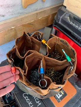

For most jobs, I lean on what I call my “80% parachute bag.” This contains the fasteners I use about 80% of the time: 2-1/2‑ and 3-inch GRK general-purpose wood screws; 2-1/2- and 3-inch GRK trim-head screws; 1-1/4‑inch Kreg pocket-hole screws, and 2-1/2‑inch cabinet screws. Each kind of screw has a color-coded bit in a bit holder that’s the same color, hanging with the related screws. The purpose here is to travel light and save trips to the truck. I do have a far more varied and extensive selection of screws on the truck, if I need them.
