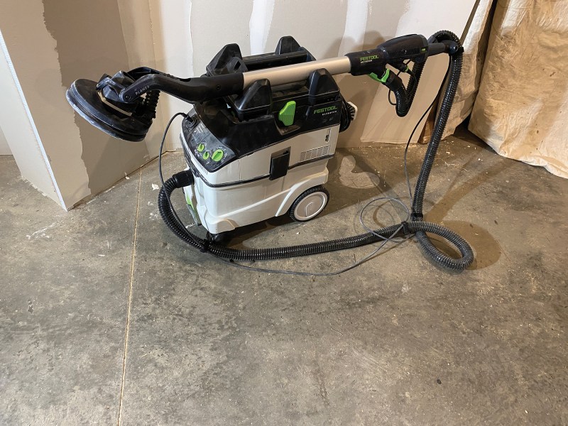

The CT36 dust extractor comes with a removable cradle for holding the sander when not in use. The top of the extractor will also fit the Festool Sustainer boxes

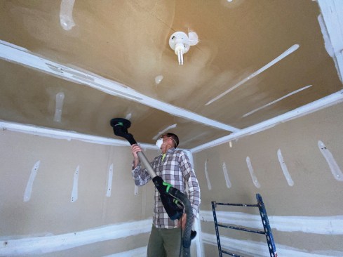

This new sander design has a lot more holes in the sanding head, so you can’t use the old papers on the sander, or, at least, you shouldn’t—so that it works at its best. Those numerous and smaller holes help collect more dust compared with older models.
While the T-handle may feel odd at first, its position makes sanding overhead much more comfortable.
Another feature of this model is that instead of using just a rotating head, it has a random orbit sanding motion, which helps reduce any scratches that you might cause with a typical power sander. One thing to keep in mind is most of us are using lightweight compounds for the final coat, so be sure you’re not using too coarse of a sanding grit. I usually go with a 220-grit sandpaper.
At first, I wasn’t too sure what I thought of the handle having a T-grip on the end, but it turned out to be handy. It is necessary to use the attachment that holds the hose and power cord away from your hand. I didn’t attach this at first, and it seemed like the hose and cord were always getting wrapped around my arm, so that’s a feature you’re going to want to take advantage of.

The number one concern I have when using any power sander is how much dust control it has and, here, the Planex exceeded my expectations.
Also, I used the unit with a Cleantec dust extractor vacuum, which does an excellent job. It has an auto-clean system that cleans the filter as you work to maintain suction. This was the first time I used the plastic bags that fit inside the Cleantec to capture dust; all you need to do is unhook the bag and throw it out when it’s full. While I think it’s good feature, when I run out of the bags, I probably won’t replace them. I just dump the dust into the garbage from the vacuum. You have your sanding tool, you have your dust extractor, and then you can use the cleaning kit for the vacuum to clean the floors, electrical boxes, and around windows and door cutouts. I liked using the complete system.
If I’m going to have a complaint, the hose and cord for the sander are too short for my taste. I always attach an extra cord, and I buy an extra hose and connect it to the one that comes with the tool so I have twice the length. I don’t want to be dragging the dust extractor along with me; I want to put it in the center or corner of the room and sand that whole room without having to pull it along. I believe Festool makes an attachment sleeve for attaching two hoses together. I didn’t have one of those, so I just taped the hoses together—that has worked fine over the years for me.

The Planex is high-quality tool with an overall length of 55 inches, which is fine for me reaching an 8-foot ceiling. I know if I’m sanding a 9-foot ceiling, I might not be happy with the reach. So, I may end up getting on my stilts when I’m working the higher ceilings.
