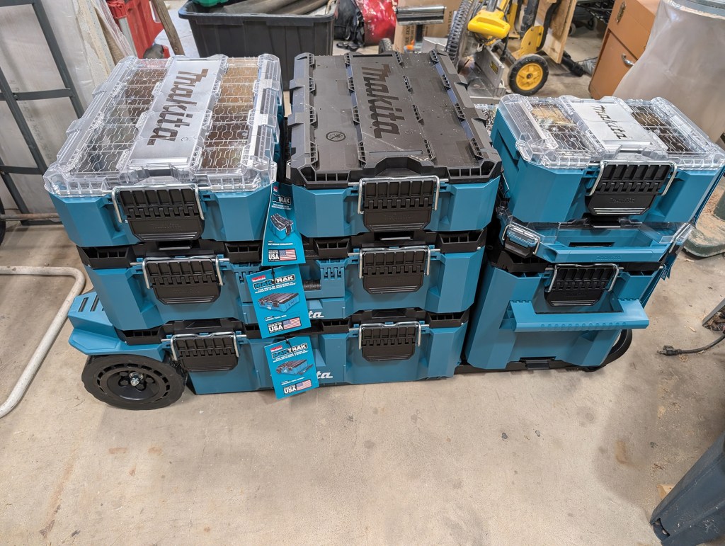

Fresh from delivery, the new storage system from Makita is about to be put to the test.
For several months, I have been using Makita’s new modular packout system, the Maktrak. I’ve brought the full seven-box configuration with me to many jobsites with various working conditions, which has been a great way to test its durability, versatility, and mobility.
The first challenge for the Maktrak was that my small, older-model Tacoma pickup truck has no tonneau or cap on the bed. That meant that whenever the containers were in the truck, they were exposed to the elements. But rain, sleet, snow, you name it, the Maktrak had me covered. No moisture ever leaked inside. The lid of each container is double lipped with a rubber gasket all the way around, forming a waterproof seal when it is latched. This seal protects against dust and debris, too, when the containers are near a working area on the jobsite or in the shop.
Another feature of the design is that cables connect the lid and base of the large boxes. Even with the bins above full of tools, they prevent the boxes from flipping over. The cables are removable if you ever want to fully remove the lid. The bins all can be locked into each other from the left or right; however, the release lever to disconnect them is on only one side of each unit.

Makita Maktrak storage modules come in seven styles. The large bins have hinges on two sides for better access and a removable safety wire to prevent tipping.
Labels on the lids clearly warn against using the containers as a step and, while I never used them as that way, they were definitely sturdy enough to accommodate a planer and router table. The lids are a thick, molded plastic and, so far, none have cracked or warped, or appear scratched.
The system lends itself well to customization. Each bin comes with removable trays and dividers, allowing everything to fit snugly. On the rolling tool chest, the large toolbox, and the extra-large extension toolbox, the inside of the lid has slots for Velcro to loop through for organizing the contents even further. When I first received the Maktrak, I transferred every tool in my previous system (from a different manufacturer) to it, plus other tools that were floating around, and I still had room to add more—and I keep finding ways to add even more.

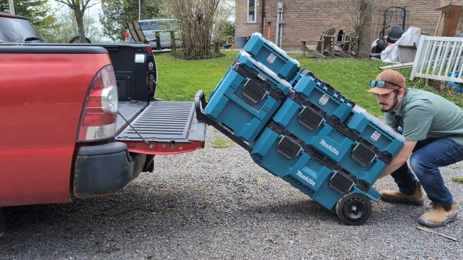

The added weight can complicate loading it as a unit in and out of the truck. To help with that, the Maktrak’s rolling tool chest handlebar has rubber gecko grip stoppers that are meant to hook onto the end of a tailgate and provide a pivot point when you grab the tool chest from the back end, lift it up, and slide it into the bed. This design reduces the lift strain and makes sliding in all seven boxes, even fully loaded, a breeze.
James Burgess
Using the handle on the rolling tool chest, the author levers the fully loaded stack into the truck as a unit.
