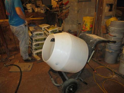

With the MultiQuip Mix-n-Go mixer, however, I was able to carry the mixer to the job in my pickup truck. At the job, my helper and I carried the 138-pound, 3-cubic-foot mixer down a short set of steps, then rolled it another 30 feet to its final position inside the basement. We set it up a few feet away from the first pour, which was a footing.

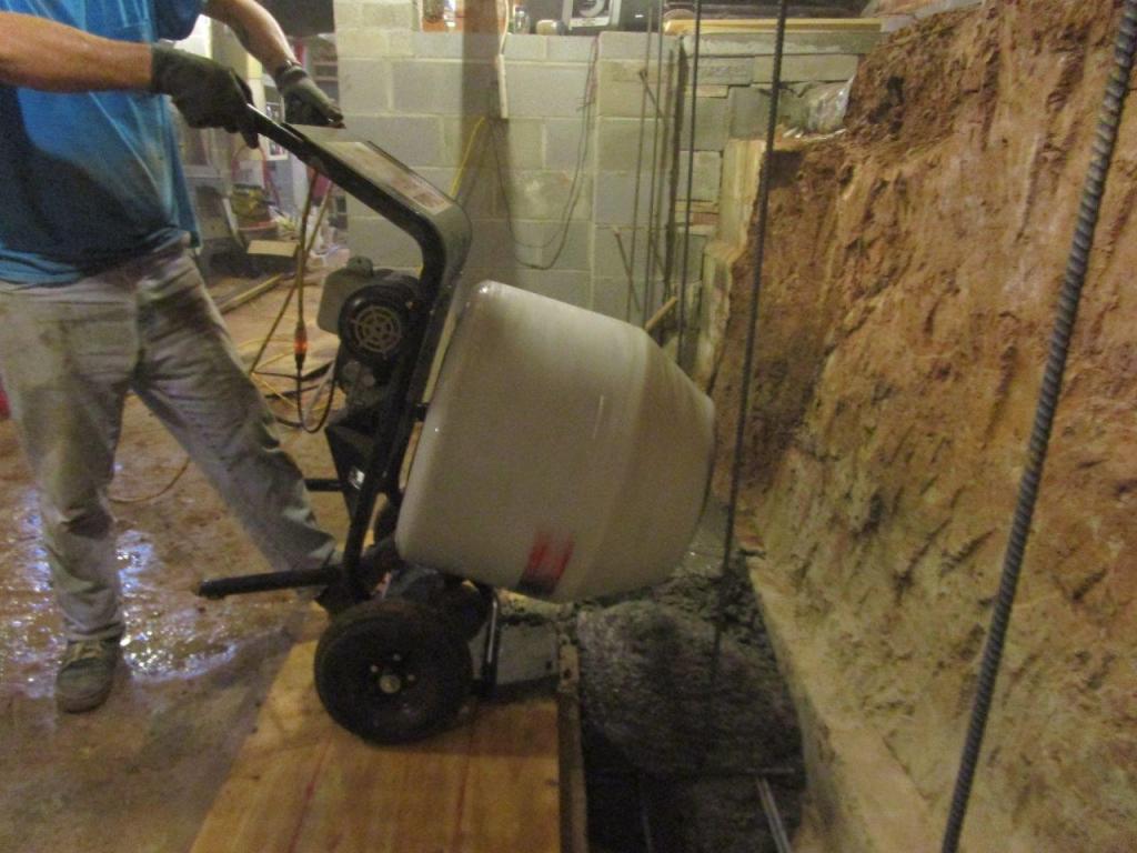

The Mix-n-Go can be set up in two ways. In the first, it sits low on two wheels and two short legs that hold it at the correct angle for mixing. In this configuration, I mixed two 80-pound bags per batch, then rolled the mixer over to the footing and poured the mixture directly into the trench. Using it this way is like having a combination mixer and wheelbarrow. It’s perfect for small, ground-level pours.
The compact MultiQuip MC3PEA Mix-n-Go mixer fits in the back of a pickup truck and—measuring only 24 inches wide—can be wheeled through a doorway. When mounted on its included stand, mixed batches can be poured into a wheelbarrow, but mixed concrete can also be poured directly into a form.
The second pour on this job, though, was not at ground level. After I had built a block wall on the footing, I had to mix and pour reinforcing grout (rich, flowable concrete) down every fourth core of the blockwork. To do this, my helper and I set the mixer on a metal stand that comes with the unit. My helper then made the grout and dumped it into a wheelbarrow. Using a small bucket, I scooped the concrete out of the wheelbarrow and poured it down the cores.
The third pour was a 4-foot-by-12-foot slab 5 feet above the floor. To do this pour, we again set the mixer on the stand and dumped the concrete into a wheelbarrow, then placed the concrete by the bucket. At the end of each pour, we rolled and carried the Mix-n-Go outside to clean it.
