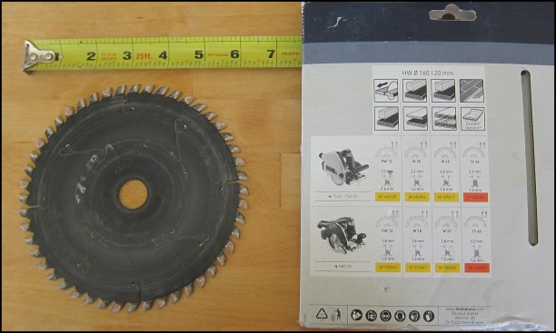

A variety of saw blades are available, depending upon the task—including crosscutting and ripping—and material. I stick with one blade 99% of the time, a proprietary 48-tooth ATB (alternate tooth bevel) blade. I don’t cheap out when it comes to tools, and there’s little difference in cost between these typically 6 1/2-inch blades and their 10- and 12-inch compatriots. But cutting plywood, which is probably 80% of my application, is successfully done with a single blade type, given one caution: To avoid tear-out when crosscutting, I always first make a shallow cut, severing only the top veneer, and then I reset the blade depth to complete the cut. This is quick and simple to do with a track saw.
A variety of saw blades are available, depending upon the task and material. The author sticks with one blade 99% of the time, a proprietary 48-tooth ATB (alternate tooth bevel) blade.

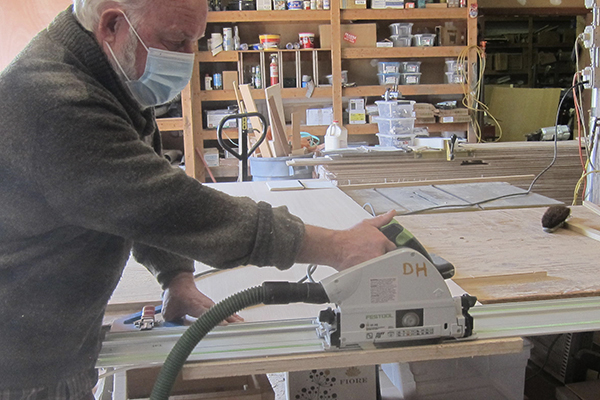

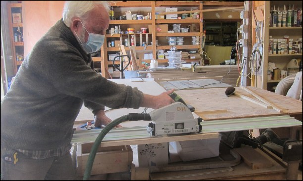

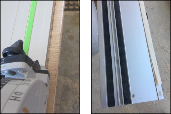

Depth of cut is quickly registered and adjusted on a track saw. To avoid splintered veneer, first make a shallow pass (left), then recut at full depth. Black friction strips provide admirable grip on the cutting surface (right), but the splinter guard edge (white, at right in photo) is less reliable, drifting and delaminating in use.
I don’t count solely on the vinyl strip—allegedly the “splinter guard”—at the edge of the rail to prevent or subdue tear-out. In fact, I’ve come to rely less on the splinter guard even for initial cut alignment, its equally touted application. When it’s new, it is reliable referenced against your tick-mark. But with repeat use and attendant abuse, the strip becomes frayed, dislocated, and partly detached, especially at either end, which is typically where you line up your cut. Plywood, along with every other material, isn’t dropping in price, and spoiling a sheet is all too easy. So, when my edge is in weathered condition, I make a slight, exploratory entry nick to make sure the blade is lined up on the mark and adjust the track position accordingly.

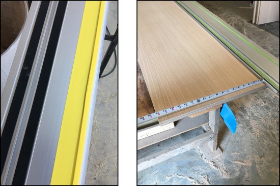

Replacement guard strip is only slightly south of $50, so if you’re replacing yours, first thoroughly clean the old adhesive from the track with mineral spirits, followed by denatured alcohol, which, unlike mineral spirits, leaves no chemical trace of its own to compromise adhesion. I’ve taken to reinforcing replacement strips with a band of vinyl tape. Make your first cut to trim the new edge, then enjoy the renewed precision while it lasts.
When I make parallel cuts using a track saw, I first register the entry position with a test nick, then measure from the opposite edge of the material to the back edge of the track, rather than referencing the strip edge. I then position the far end of the track to that exact back-edge dimension, double-check both end dimensions, and make the cut. While the friction strips on the underside of the rail do a fairly miraculous job of anchoring it to the material, an accidental bump or shift is still possible. Track clamps instill peace of mind and should be an early buy on your accessory list.
The author bolsters the splinter guard with vinyl flashing tape (yellow) to help prevent dislocation and extend its useful life (left). For parallel cutting, measuring to the back edge of the rail eliminates the uncertainty related to a ragged, time-worn splinter guard (right).

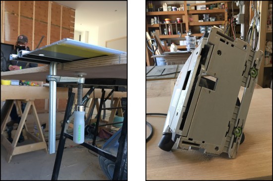

Avoiding kickbacks. When I was first familiarizing myself with a track saw, I neglected to ensure that its shoe groove was correctly engaged with the rail, and I managed to saw a small kerf into the rail itself. Since then, I’ve gotten in the habit of sliding the saw back and forth on the track to check engagement before pulling the trigger. And once you do pull the trigger, wait for the saw to come up to speed, about one second, before plunging into the cut. If you don’t, it’ll kick back. Plunging is how the saw is engaged and is ergonomically intuitive. When you are done cutting, the spring-loaded retrieval allows you to set the saw down just about anywhere, as the blade is completely and safely enclosed.
Friction strips are impressively grippy, but track clamps offer locked-in peace of mind for holding the line (left). Safety is greatly enhanced by the fully housed saw blade (right), exposed only during plunge-cutting, the operative mode of these saws.

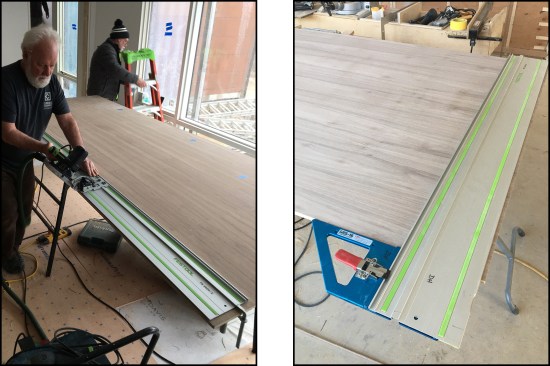

Bevel cuts. Track saws are designed to enter the cut line at the exact same point whether the cut is square or beveled, so there is no adjustment needed in approach. Although the body of the saw is heeled out over the track edge during the cut, it remains smooth and stable in action and delivers a glue-ready miter. A mild back-bevel of 5 degrees or so is a great aid to executing scribed cut lines, whether you’re prepping a board for scribing or actually cutting to the scribed line, depending upon its complexity. I’ll often shift the track along a scribe line and remove 99% of the waste material with the track saw before final planing or belt sanding to the line.

I recently acquired a GRS-16 guide rail square that cam-clamps onto the rail edge and sets you up for accurate 90-degree crosscuts. I’ve found that the accuracy is best on narrower cuts, but double-check with a good square when you’re cutting across something as wide as a 24-inch panel. Apparently, using a guide rail square at both ends of the rail ensures total accuracy, but I haven’t tried it or bought a second rail square; that seems a little fussy, and expensive for the perceived convenience. Festool also offers a similarly functioning adjustable protractor for angle cuts.
Bevel cuts, between 0 and 45 degrees, track precisely along the rail edge without any adjustment to position. Here, the author miter-cuts 10-foot black-walnut plywood, using a 118-inch stock rail (left). A TSO guide rail square (right) converts a rail into a convenient, 90-degree crosscutter, though it's less reliable on wider panels, for which a precise square is advised to ensure accuracy.

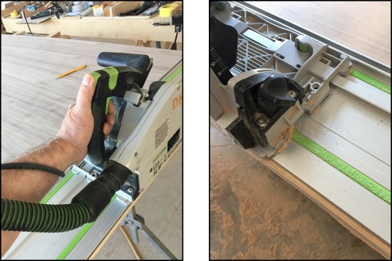

A tool-actuated vacuum or a dust collector should be considered a primary accessory, since it beautifully controls sawdust, which otherwise accumulates on the track and jams the slide action. When I’m making a few quick cuts, I sometimes skip the vac hookup, but then I end up needing to sweep the rail clean between every cut. Bluetooth-equipped batteries actuate paired dust collection with Festool’s cordless saw, but, for me, the vacuum hose is a bigger drag on movement than the cord.
A combination of cord and hose typically snags and drags at the back of the track; the author has adopted an over-the-arm drape to help alleviate this annoyance (left). On the occasional cut made without a vacuum hookup, sawdust quickly gums up the rail; constant clearing is needed (right).

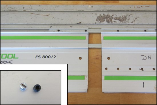

Guide rail connectors allow you to assemble multiple rails to unlimited lengths, with the caution that a continuous straight edge isn’t automatically provided; I always check the connection against a reliable, second straightedge. The slots in the set screws provided by Festool also quickly strip out; I’ve replaced mine with 5×5-mm hex-head units. A limit stop is useful when you want to prevent overtravel, say in an interior cutout operation. While blade progress remains visible during cutting, a stop firmly guards against the oops factor.
Rail connectors permit rails to be combined to virtually unlimited length but don't guarantee perfect alignment. Keep a slight gap between segments and confirm true alignment with a separate, reliable straightedge. Slots in the proprietary set-screws become distorted with repeat use; the author replaces them with 5x5-mm hex-socket screws (inset photo).
Rail connectors permit rails to be combined to virtually unlimited length but don't guarantee perfect alignment. Keep a slight gap between segments and confirm true alignment with a separate, reliable straightedge. Slots in the proprietary set-screws become distorted with repeat use; the author replaces them with 5×5-mm hex-socket screws (inset photo).

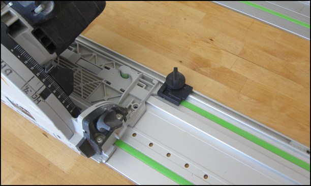

This limit stop slides and clamps onto the rail at any selected position, preventing accidental advancement of the cut.

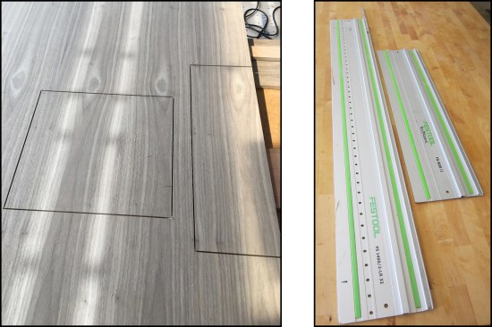

Precise, interior plunge cuts are quickly made, challenging any other method that comes to mind (left). Having a selection of rail lengths enhances the flexibility of the track saw system (right).
If you’re careful about ensuring straight connections, a selection of shorter rails will serve just about all your needs; single rails up to nearly 10 feet in length are quick and perfectly straight but almost painfully expensive.
