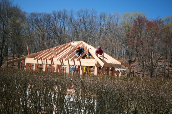

Start by framing the common rafters along the ridge. The last common rafters that support the ridge are called king commons (see illustration). An additional common rafter that extends from the end of the ridge down to the plate at the end of the building is also called a king common. The king common at the end of the ridge and the king common on the side of the ridge intersect at a 90° angle. The hip rafter intersects this 90° angle at a 45° angle and runs diagonally down to the building corner.
The king commons at the ends of the ridge are the same length as those at the sides. Each common, including the kings, has an “adjusted run” that equals the run shortened by half the thickness of the ridge (in this case, using 2-by stock, the run is shortened by 3/4 inch). If both ends of the building end with a hip, the length of the ridge is the total length of the building minus two times the adjusted run of the common rafters. (For details on calculating ridge length, see “Framing a Hip Roof,” Sep/13.)

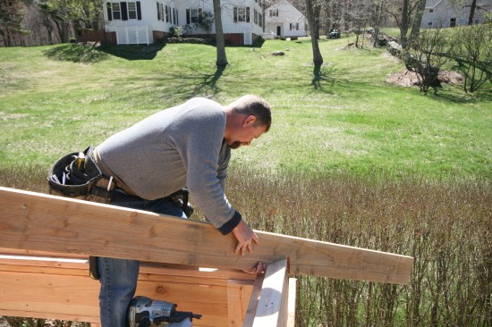

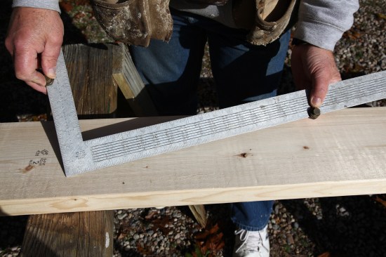

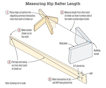

The conventional way to determine the length of a hip rafter is by using the “Length of Hip per Foot of Run” table on a framing square or by using a construction calculator. But rather than depending on the math, I find it easier (especially on smaller roofs) to physically measure the length as shown in the illustration Measuring Hip Rafter Length. I start by making a short pattern of the ridge cut for the hip. For this, I need the plumb angle for the hip, which is calculated as the rise-per-foot/17. So for this 6:12 roof, the plumb angle on the hip is based on a 6:17 slope.
The easiest way to lay out the angle is with stair gauges attached to a framing square. These little hexagonal devices clamp on the edge of the square—one at the 6-inch mark and one at 17. When you slide the square to the edge of the board, the gauges “stop” the square at the proper angle for the hip slope.

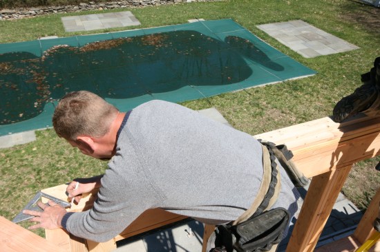

Using this angle, I make a double 45° cheek cut on my pattern. I then place the pattern in the corner between the two king commons and mark where the shoulder of the cheek cut meets the kings.
Next, I move to the building corner and on top of the plates, I draw a 45° angle that bisects the corner. I then measure over half the width of the hip rafter—3/4 inch for 2-by stock—and draw a parallel 45° line.

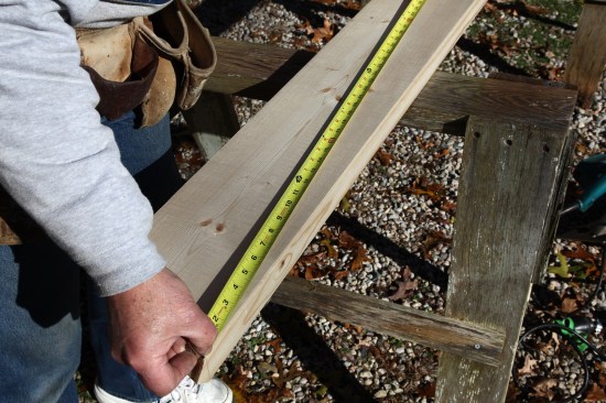

Holding the tape on the shoulder mark that I made on the king common using my ridge-cut pattern, I measure down to where the line for the side of the hip meets the outside edge of the plate, and I record that measurement. (Note: This is not the same length as the hip rafter “line length,” which is the figure you would find using a calculator or the table on a rafter square to determine the hip rafter length.)
Hip Rafter Layout

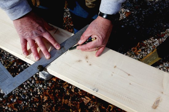

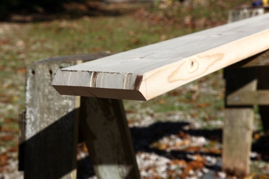

For the hip rafter, I choose a lumber dimension one increment up from the size of the common rafters. In this case, I’d used 2×6 stock for the commons, so I went with 2×8 stock for the hip. (If the commons were 2×10, I would have used 2×12 stock for the hip). Be sure to mark the direction of the crown on the hip board and keep this as the top edge of your hip rafter.

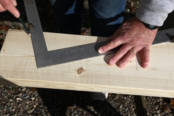

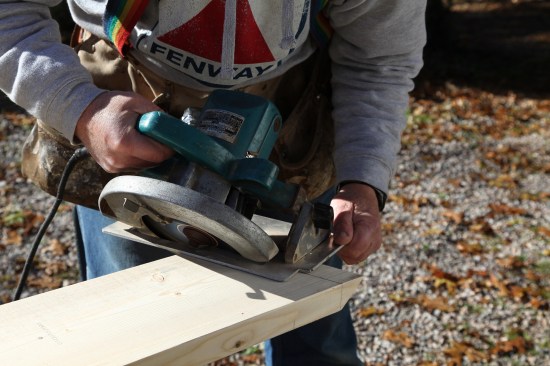

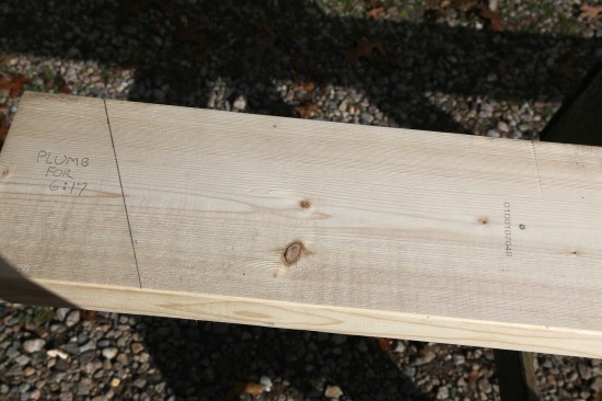

On one end of the stock, I cut a double 45° cheek cut along a plumb line for a 6:17 roof. To lay out this double cheek cut, I draw a plumb line on one side, square this line across the edge, flip the board over, and draw another plumb line on the opposite side. These define the short points of each cheek cut. After setting the blade angle on the saw to 45°, I cut all the way through the board from one side. (Because I am cutting the short point line, I keep the saw blade angled towards my offcut.) Then I flip the board over and cut from the other side. The cheek cuts should meet in the middle of the hip stock.

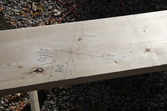

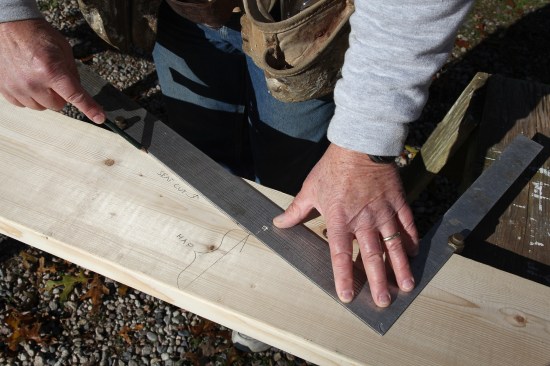

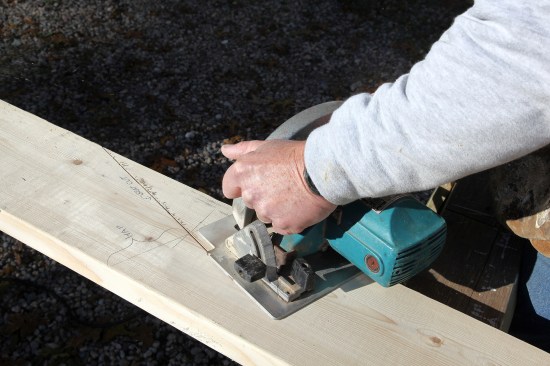

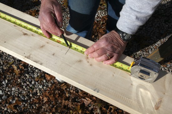

Next, a crew member holds the end of the tape on the short point of the cheek cut (at the top edge of the hip rafter) while I hold a pencil at my length measurement and trace a shallow arc across the width of the board. With the framing square set at the 6:17 angle, I slide the square up to the arc and mark the point where the HAP distance along the plumb side of the square intersects with the arc. That point is where the seat cut of the hip rafter starts, so I slide the square down and draw a level line to the edge of hip stock, using the “level” side of the square. (Note: The plumb cut for the birdsmouth has to be moved out to clear the plates and sheathing.)

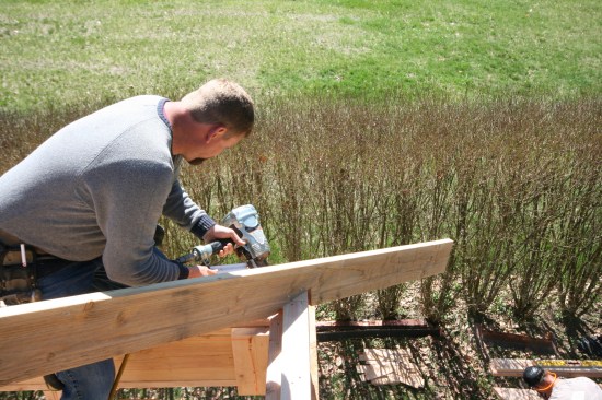

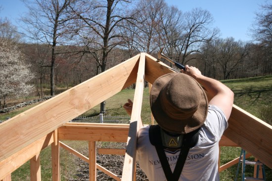

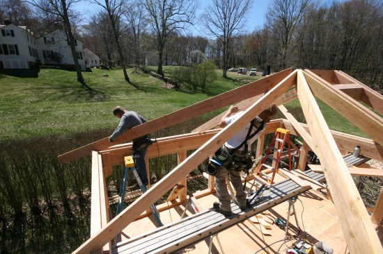

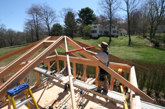

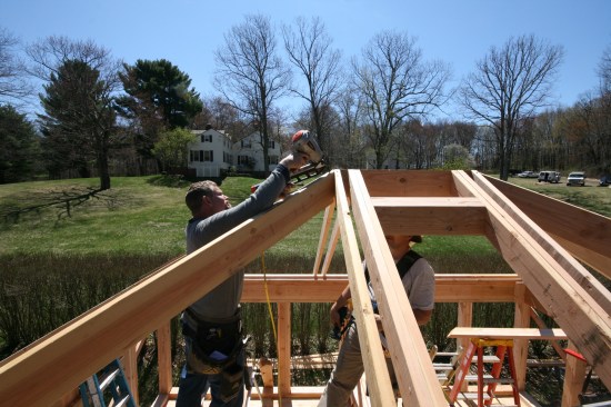

Recall that we drew lines on the plate at the corners when we took our measurement. Those are also our layout lines for placing the hip rafter. When we install the hip rafter, one crew member holds the bottom of the hip rafter on the layout line while another crew member sets the top end between the king commons and taps it down until the shoulders of the cheek cuts are flush with the tops of the king commons.
When the top is set, I make sure that the side of the seat cut is on the layout line, and then drive toenails to secure the hip to the plates on both sides. To secure the top of the hip in place, I drive nails through the king commons. If that isn’t possible, I drive a nail through the top of the hip and into the ridge. If everything is done properly, the roof planes from the king commons to the hips should be perfectly flat.
