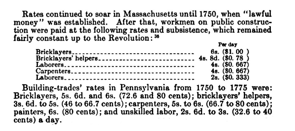

In the image above, the wage figures in parentheses show dollar equivalents in 1928 (the time of this study). A 1928 dollar equals about $15 today. These wages seem low, but there wasn’t much to spend money on—except land. Though the details around landownership and indentured labor were sometimes complicated, salable land was plentiful and, at around $2 an acre, affordable to many trade workers.
A glance above at an excerpt from the wages study shows this condition existing in the colonies for almost a century, and it’s hard to think of these rates as very great or inviting. The study notes the 1928 dollar equivalent in parentheses, and in today’s dollars, it is still very low as a day rate (a 1928 dollar translates to about $15 in today’s dollars). Yet details in the wage study give us rich insight into the life of Colonial tradesmen that must be considered when comparing their status to a modern context. The quality of life in the Colonies was not what we think of today. Homes were heated with fireplaces; churches were entirely unheated. Nothing in the way of china, glassware, or carpets existed, to say nothing of lighting, indoor plumbing, appliances, or cars. In other words, there were few commodities to buy. What constituted wealth was land, and owning land afforded political rights and prestige in the Colonies. At a rate of about $2 an acre, land was accessible to trade workers in ways it never was to commoners in Europe, making the building trades an attractive way to make a living in the nascent United States.
