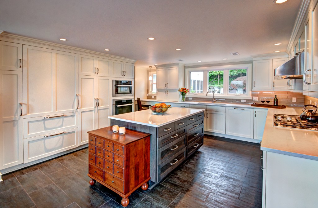

This former galley kitchen tripled in size after its remodel, Paul Kocharhook says. He chose low- to no-VOC products throughout the space to benefit both homeowners and workers.
Joe Bianco

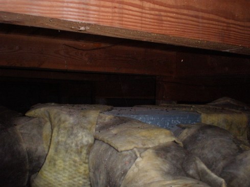

When thinking of the home’s IAQ (and in thinking of the home as a system), it’s important to understand where the air is coming from. Air can travel from a crawlspace through the living environment and up out of the attic. In some cases, air is even pushed back down through the attic and into the home.
Broken-down fiberglass insulation and rodent feces surrounded this ductwork and was being pulled into the home's air, Kocharhook says.
Paul Kocharhook
Considering that crawlspaces can contain moisture, soil gases, and rodents and their droppings, while attics can contain critters, bugs, and old insulation, it’s not the kind of air anyone wants to breathe. To prevent that icky air from getting into a homeowner’s living space, experts stress the need to properly seal off the indoor air space from the crawlspace and attic.
