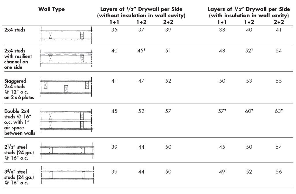

Sound transmission ratings for various wall assemblies. Note: 1+1 refers to 1 layer of 1/2-inch drywall on each side of wall; 1+2 refers to one layer of 1/2-inch drywall on one side and a double layer on the other side, and so on.

We get a lot of calls from customers in recently built Boston condos who are hearing too much noise from the unit next door. There are rules now in the building code about soundproofing in condominiums and apartment buildings, but the code doesn’t tell you how to build an assembly, it just tells you the rating you have to achieve.
Party walls, floors, and ceilings are rated according to a “Sound Transmission Class,” or “STC,” that indicates how well they impede the passage of sound. The higher the STC, the better the element performs (that is, the less sound is transmitted). By code, walls between multifamily dwelling units should have an STC of 50 (if measured in the laboratory) or 45 (if measured on site in the field).

First of all, the code-required STC, like everything else in the code, is only a minimum. STC 45 or 50 is not very good. In a condo that just passes the code, you can still hear loud conversations, loud televisions, or thumping and bumping from next door. And how much a person is bothered by any kind of noise is subjective; it depends as much on somebody’s sensitivity to noise as it does on the measurable sound.

We also have to understand the nature of the noise. There are different kinds of sound, and they travel differently. Voices or amplified music travel through the air. To stop those, we use a combination of airsealing and sound-absorbing material.
Footsteps, on the other hand, are an example of “impact sounds” that travel through structural framing, not air. (Bass notes from a subwoofer also travel through framing.) Structure-borne noise is harder to stop because it requires the framing to be isolated from other framing or from the space in the room.
