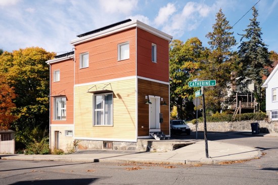

Placetailor’s trademark look—an unpretentious, contextual modernism—gives its projects a distinctive presence in Boston’s residential neighborhoods. The company has boosted that presence in recent years by undertaking its own residential development projects, typically deep energy retrofits of existing homes. “We analyze how much solar [capacity] can fit on the roof, and then we design the building so the amount of renewable energy we can get from the building will offset its anticipated energy use,” Keefe says.
“We don’t put the solar on ourselves, because [homeowners] get better rebates. If the buyer has the money to do it or ties it into their mortgage, it’s absolutely a worthwhile investment,” he says, “but we’re getting the energy load so low that some people opt out, because they’re only paying $20 a month or something like that for their whole house electric bill.”
