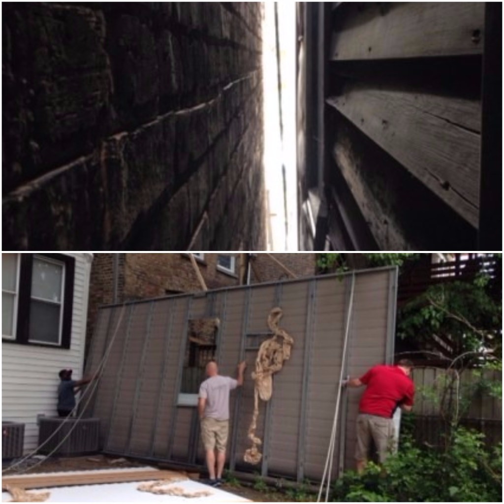

In a city, working closely do the neighbors doesn't always mean working on top of their home; sometimes it means working closely next to them. Case and her team had just six-inches of space in which to install new siding for their project (top image), so they attached it to a large panel and affixed the panel to the home (bottom image).

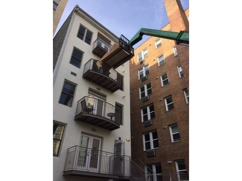

One homeowner wanted this great new shower and one panel was 80×72. It didn’t fit through the front door, up the staircase, or through any of the windows. We had to cut the roof, crane the panel up, and slip it between the joists to install it. That was a big challenge.—Dan Dragomir, dRemodeling, Philadelphia

We had six inches of space in which to replace siding. We built a 20×20 steel structure consisting of three separate panels. We attached vinyl siding to the structure and hung the structure on the side of the house. We then adhered it from either side. —Allyson Case, Integro Rehab, Chicago

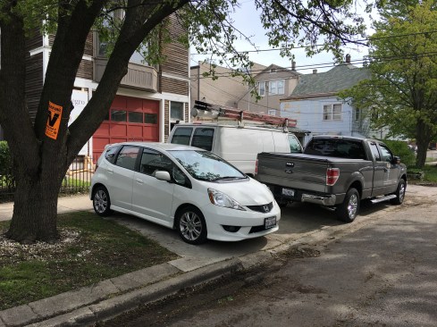

Predictably, parking was another issue for city remodelers. Scarce parking, compounded by the fact that many city homes lack driveways or designated spaces, requires remodelers to be crafty. A few remodelers say they will rent spaces from the city or pay off whatever parking tickets their staff may accrue. Rusk and his team typically travel in cabs or on the subway (as many New Yorkers probably do), while Landis says his team will meet at one place and carpool to the jobsite to cut down on the number of vehicles. No matter where or how workers park, parking affects the cost of the job and is a consideration for these remodelers when they are pricing out the projects.
