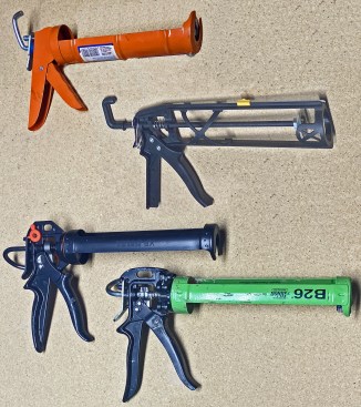

Caulk guns. Don’t skimp here; buy a good caulk gun. If you are using the cheapest gun available from a big box retailer, you can still lay down a good bead, but it will be an awful lot harder and will take longer.
Your choice in gun format will largely depend on the type of caulk you use. Most caulks for residential uses come in 11-ounce plastic or cardboard tubes, for which you can use a standard “half-barrel” gun or a “skeleton” gun. The least expensive, most ordinary guns have a half-barrel of steel to hold the caulk tube. A small step up is a skeleton gun, which has only a spare frame around the caulk tube. Also called simply “frame guns,” they tend to be lighter and easier to clean.
11-ounce guns: While basic “half-barrel” (orange) and “skeleton” guns (second from top) work, they’re harder to use than professional-grade tools, which have a higher thrust ratio. The Irion-America gun (third from top) lets you switch between 12:1 and 25:1; the green Albion has a 26:1 ratio. The higher the ratio, the easier it is to apply more-viscous caulks.

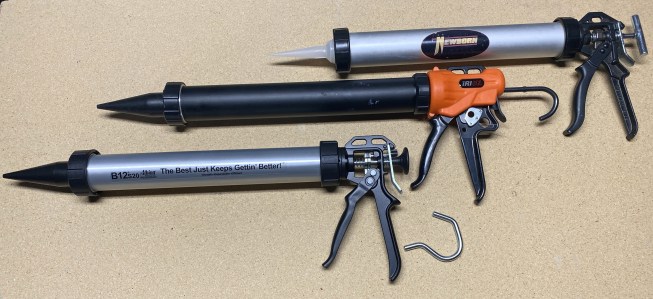

High-quality caulks, sealants, and liquid-applied flashing compounds often come in 20-ounce sausage packs—foil or plastic sleeves that are a bit like a package of Jimmy Dean sausage, albeit thinner and longer. To apply this type of caulk, you need a gun with an aluminum or plastic tube to hold the sausage pack. In commercial and industrial work, we also see bulk-load guns that have a canister you fill from a 5-gallon bucket of sealant, but I have never seen those on a residential job.
20-ounce guns: All three “sausage” guns above are designed to hold sausage packs of sealant and have a 12:1 thrust ratio.
Thrust ratio. One of the most obvious characteristics of different types of caulks is their viscosity. Latex and silicone caulks are relatively “loose,” or thin, and tend to be easier to squeeze out. Stiffer caulks include polyurethanes and butyl. The stiffer the material, the harder it usually is to squeeze out. If you are using a thicker caulk, a gun with a higher thrust ratio will make it easier to apply. A higher-ratio gun is also good for working in colder temperatures, in which even some high-solvent caulks will be stiff.
Ordinary ratchet-style guns have a thrust ratio somewhere around 4:1 to 6:1. This means for every pound of force with which you squeeze the trigger, 4 to 6 pounds of force will be delivered at the plunger. You get some mechanical advantage, but not a lot.
As they improve in quality, guns have higher thrust ratios. Albion, Irion-America, and Newborn all offer professional-grade guns, and most of these start at a 12:1 thrust ratio. Higher ratios—on the order of 18:1 and 26:1—are common from pro-grade makers.
Keep in mind that a higher ratio does not necessarily mean better. Most guns for applying high-quality caulks sold in sausage packs will have a 12:1 ratio. In warm temperatures, most of the liquid flashings and other sealants that come in sausage packs tend to be fairly “loose,” and a 12:1 tool works well to apply them. Using a higher ratio tool, while good for a stiff caulk, makes it harder to control the flow of thinner materials. Irion-America makes a switchable tool that goes from 12:1 to 25:1. It’s an excellent tool, and great if you are using a variety of caulks, but it’s pricey (it runs about $85; a tool of comparable quality at either 12:1 or 26:1 will cost from $35 to $50).

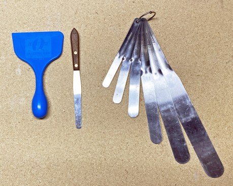

Tools for tooling. I recommend tooling caulk joints with a tool, not your finger. But such a “tool” can be as simple as a plastic spoon (if you use a spoon, be sure to knock off any fringe of plastic on the edges that might create drag lines; you want a nice, smooth edge). The purpose of tooling is simply to press the caulk into the substrate. The goal is not necessarily to make the bead look nice (though it can do that, too); it’s to ensure the caulk is fully bedded in the joint. This gives the caulk the best chance of staying adhered to the substrate.
For tooling a joint, almost anything with a smooth, curved edge will work. The author likes the blue plastic flashing tool (shown at left in the photo above). Also shown (center and right) are a single spatula and a spatula set, both from Albion.
I prefer to use a steel spatula, like those shown in the photo above, for tooling joints. Having a set with a variety of sizes is convenient if you are doing a lot of different types of caulking with a variety of gap sizes. For example, control and isolation joints in masonry and concrete tend to be much wider than the gaps in exterior siding and trim materials. Air-sealing also presents a wide variety of joint sizes.

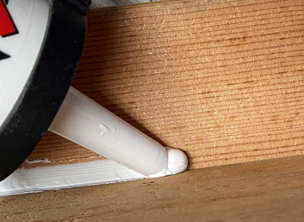

Fillets—caulk seals in corners between two substrates—are a different animal. In commercial work, it’s common to use bond breaker tape in the very corner. When covered with caulk, the tape creates two areas of adhesion that are diametrically opposed and better able to stretch evenly when the substrates move. While good in theory, this tape isn’t used in residential work, largely because no none wants to see so much sealant in corners. This means fillets tend to fail sooner and need to be applied more often.
Smush joints. A bead of caulk that will get smushed between two pieces of wood is a perfectly valid joint. However, since the caulk squeezes out when the boards are pushed together, there is a tendency to go too lean and smear the caulk on the edge. This risks gaps that will defeat the intended purpose of creating a watertight or airtight seal. I find it works best to cut a very small hole in the tip and apply a narrow but full bead, not a smear, on the edge. (With a small hole in the tip, you will need a thin wire to puncture the tube seal; I find a piece of Romex ground wire works well.) There will be squeeze-out. Fasten the boards, and then use a sharp drywall knife to scrape off the squeeze-out.
To lay down a well-bedded fillet bead, the author prefers to push the gun, keeping a small, raised puddle of caulk in front of the tip.

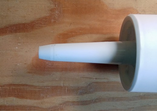

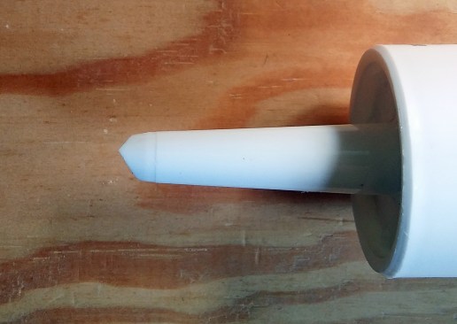

The cut on the tip of the caulk tube can make a big difference. The plastic tip on most tubes shows angled cut lines at different distances from the end, and I see most people cut open the tip along these lines. Instead, I cut the tip at two opposing angles or square to the end (see photos, above). Both methods give me a better visual on the amount of caulk coming out the end, and by holding the gun at an angle, I am able to keep a small puddle of caulk in front of the tip that I push through to create a smooth, bedded bead.
