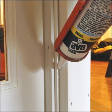

Water-based caulks typically clean up with water and cure on evaporation. Anything that cures on evaporation will shrink. Most water-based caulks are 40% to 60% solids (with some exceptions). When the caulk cures, it shrinks to the percentage of solids in the mix. Sometimes it is difficult to tell from the label what the chemistry is, but a clear “tell” of a water-based caulk is a warning on the tube to keep it from freezing. Another is marketing language that says something like “easy water cleanup.”
Acrylic caulks, even ones “with silicone,” will shrink when they cure, and are best suited for interior uses.
Ola DeKorne
Be aware that an acrylic or latex caulk that has been “siliconized” is still a water-based caulk that will shrink. I would not use such caulk on the exterior of a building. I like water-based caulks for covering up joints in trim on the interior. For anything else, I steer clear of them.

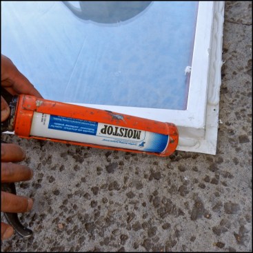

Polyurethane caulks cure on exposure to the moisture in the air. Since they do not cure by evaporation like water- and solvent-based caulks, they do not shrink when they cure. They are nearly 100% solids—you get what you squeeze out of the tube. Based on what I hear from a wide range of exterior contractors, polyurethanes are typically the preferred caulk for exterior use. The downside of polyurethanes is they do not stand up well to UV light and have to be replaced after a few years of exposure to the sun.

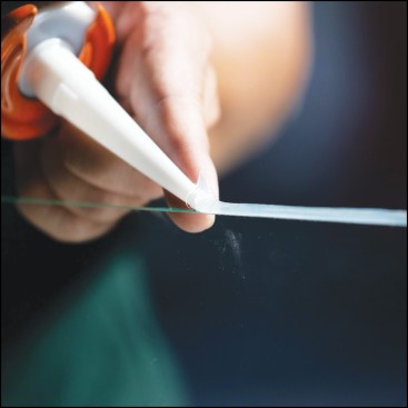

A true silicone doesn’t shrink much and works best for sealing nonporous materials, such as glass and tile; it’s often a good choice for wet-area applications.
Not all formulations are equal. There are two basic types of silicone caulk—acetoxy and oxime. The acetoxy formulation is what you will usually find on the shelves at lumberyards and big box stores. These caulks release acetic acid when curing, giving off a vinegar smell that can be an irritant to some people. Clear, 100% acetoxy formulations are unpaintable; the paint does not adhere to them and separates from the caulk. The biggest problem with acetoxy silicones, though, is they can cause corrosion of some materials. This was a bigger problem in the past, when silicone sealant technology was new and there was too much “free acid” in a lot of formulations. But even now, with mature product lines, adhesion and corrosion can be problems on acrylic, PVC, ABS, galvanized steel, and brass, depending on the product line.

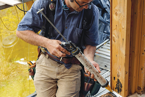

These are my preferred caulks for almost all exterior applications: They are usually easy to work with because they are typically more viscous (thicker), but you need to use a good caulk gun that has a higher thrust ratio (meaning the plunger moves a short distance for each full pump of the trigger). Some tend to skin over quickly, a property that is useful to me when I work in a light rain, because I don’t need to worry about the caulk diluting before it cures. Since we are covering a wide range of sealant materials in this category, it is wise to confirm in the tech sheets available on the manufacturer’s website that the sealant has the particular properties you want. (If the manufacturer is being cagey about revealing the material, check the MSDS, where manufacturers have to identify the ingredients.)

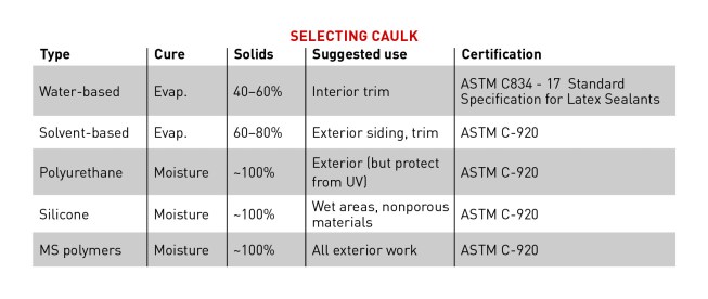

The ASTM certifications are an easy specification to look for on the label. The author suggests that any product that has not gone through the testing and certification process may not be the best choice for quality work.
