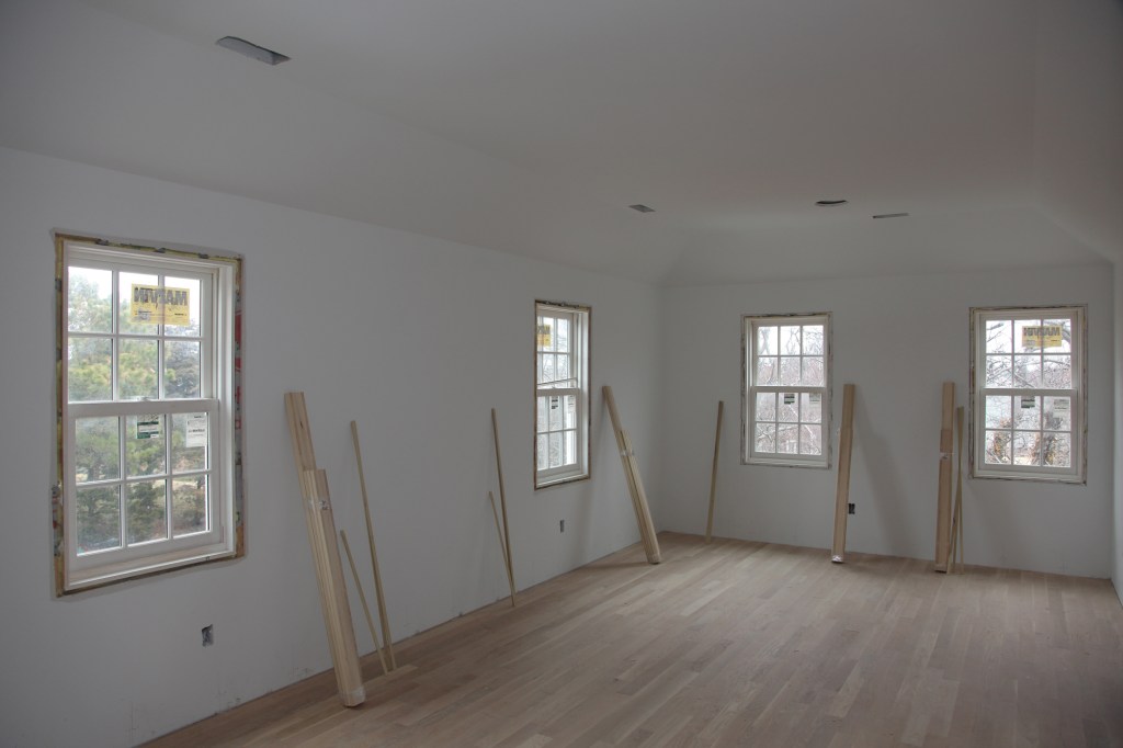

For the finish-carpentry crew on this job, one carpenter was responsible for the casing while another took care of the aprons. Rough lengths for all of the trim (including the stool stock and extension jambs) was cut as a kit and placed next to each window.
