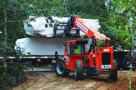

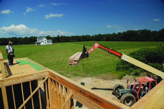

Rough terrain forklifts (or telehandlers) were designed to move material from off-loading zones closer to jobsites and to lift manageable loads to elevated work areas.
Roe Osborn
Numerous makes and models with varying reach and load-lifting capacities can be found on residential sites today. They can be challenging to operate; drivers have to contend with stability issues related to projected loads from telescoping booms and uneven surfaces. Vehicle tip-overs can occur if load limits are not adhered to.

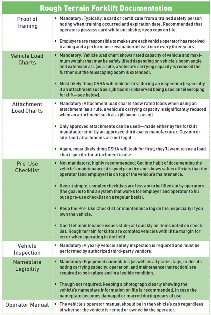

Documentation. So, what documents do you need to be “legal” and what items should you keep on the jobsite? At a minimum, you should have a card or certificate of proof of training and the vehicle load charts (and attachment load charts as well, if applicable) on the jobsite—OSHA will look for these items first. Also, though not mandatory (but highly recommended), keep a pre-use checklist and maintenance log. It’s a good habit to have and it’ll demonstrate to a safety official that you’re on top of things. For more information on what documentation you should have, both on site and in the office, see “Rough Terrain Forklift Documentation” above.
