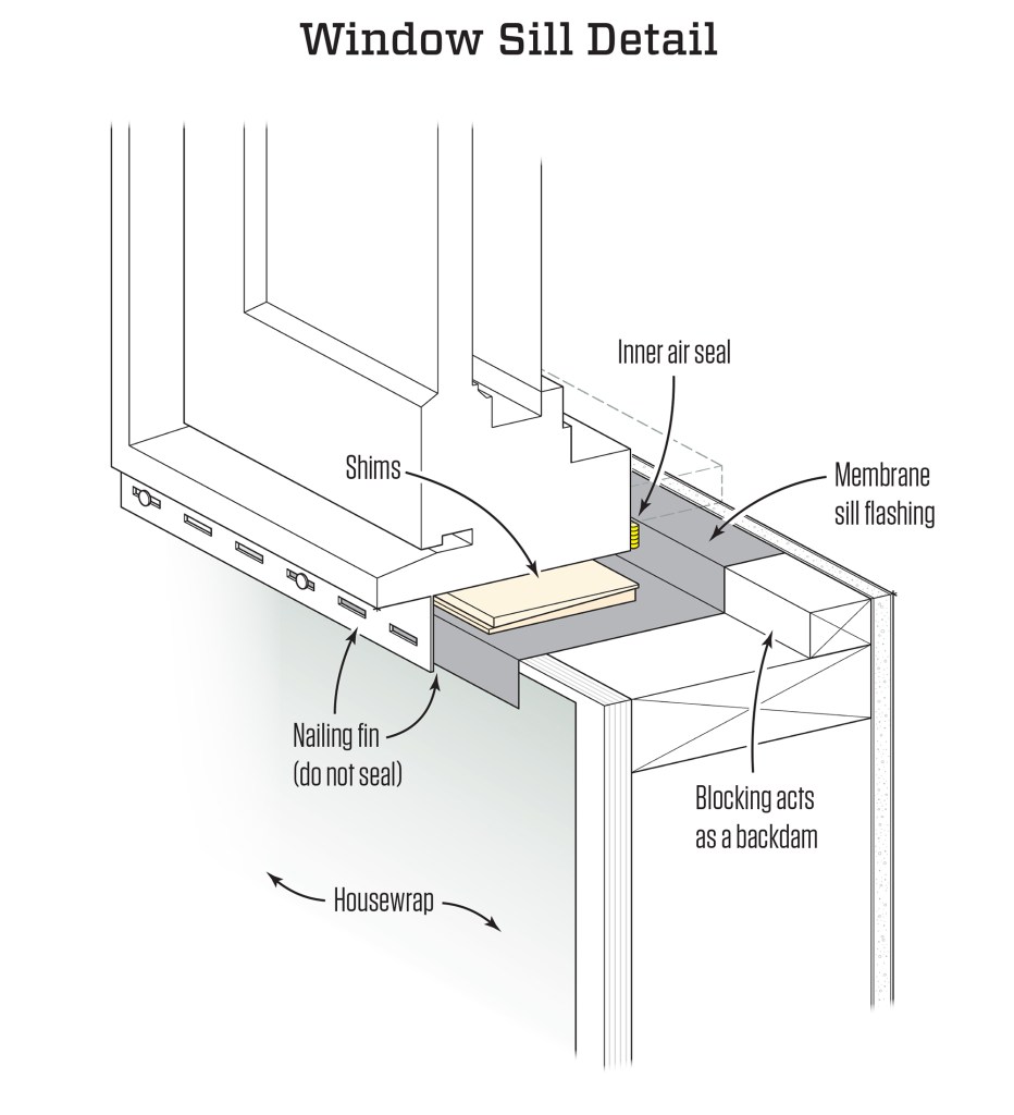

Air-sealing a window is distinctly different from flashing  a window. Flashing is done to keep water out. It can’t  completely stop air because the bottom needs to be left open  to allow water to drain out of the assembly. A window’s air  seal, on the other hand, is typically applied from the interior.  The bottom of the window is sealed along the backdam, as  shown in the illustration above. This bead of caulk should  be applied when the window is installed. As a backup to the  inner seal shown above, a fillet of caulk can also be applied in  the corner between the blocking used as a backdam and the  window unit, as shown in the photos above.

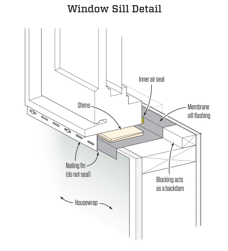

The goal in air-sealing windows is to seal the gap between the window rough opening and the window unit. Most JLC veterans know they can’t do this by stuffing window gaps with fiberglass insulation. That was a seriously flawed, old-school method. These days, you’re more likely to be handed a can of closed-cell foam, or a roll of backer rod and a caulk gun.
