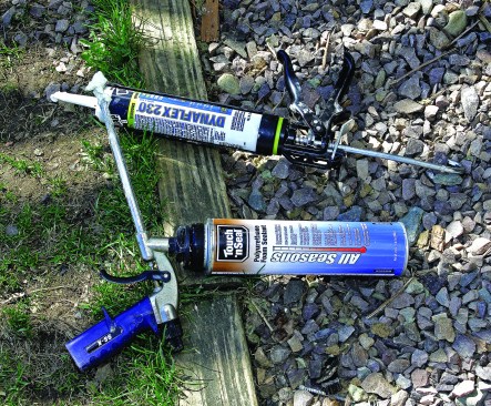

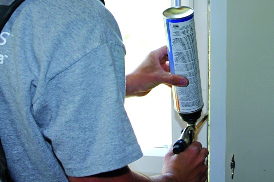

Start with good tools. A professional-grade caulk gun and foam gun (not a  plastic straw) provide needed control

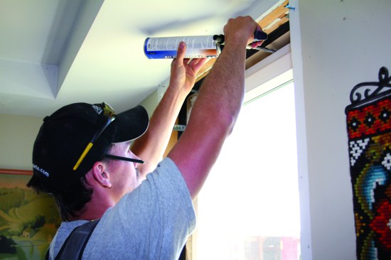

Sealing with foam. On this window, foam is applied  on both sides and across the head. The carpenter started at the upper  right corner and pulled a bead down the right side of the window.
After completing the right side, the carpenter returns to the upper right-hand corner and begins working across the head of the window.

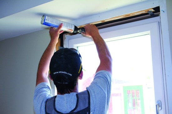

Working steadily, he pulls a bead across the window head. Note that jamb extensions have not yet been installed.

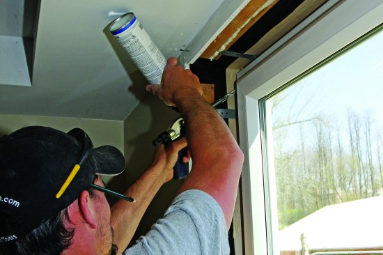

The carpenter has inserted the gun’s tip deep into the gap, so the cavity fills from the back forward as the foam expands. Finally, the carpenter turns the corner and works down the left side.

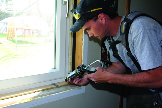

Complete the air seal by caulking in the corner between the backdam and the window.

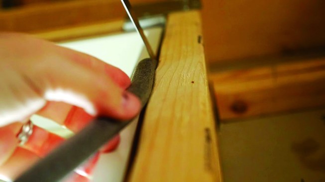

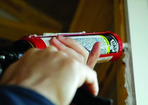

An alternative to foam. Instead of spray foam sealant, caulk can also be used to seal the wide gap at the sides and head of the window. Many builders prefer the more flexible seal that caulk provides.  But in order to make caulk work, the gap must be filled with a foam backer rod first.
Matt Risinger
Backer rod is essentially to the caulk's ability to stay flexible and stretch with dimensional changes  fthe framing and window materials over time.
Matt Risinger
