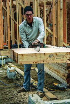

Every framing crew needs at least one 10 1/4-inch circular saw. For a long time, we have been using a Big Foot (bigfootsaws.com) 10 1/4-inch saw to cut beams. It’s one of the last corded saws we still use, though Makita recently came out with its 40-volt XGT 10 1/4-inch saw, which is quickly becoming our go-to choice. We have a 14-inch Big Foot Big Boy, too, but we prefer to use it only for exposed beams, where we want a very clean cut end.

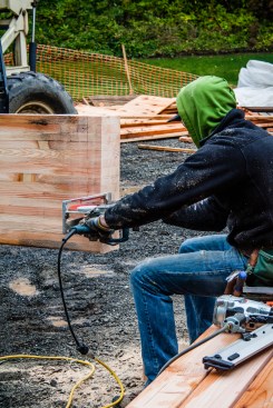

Because the maximum depth of cut with 10 1/4-inch saws is about 3 7/8 inches, we have to cut from both directions on most beams. We typically cut from one side of the beam, and then from the other, cutting vertically with the beam on edge. When you do this, make sure you keep track of what side of the line you’re cutting so you don’t end up with a stepped end cut.

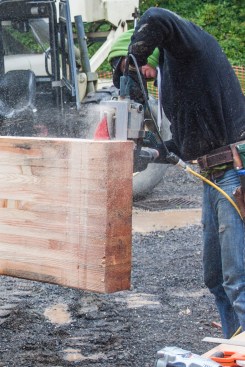

We also keep a chain saw in the truck and use that to cut beams whose ends won’t be exposed. When we use a chain saw, we first cut with a 10 1/4-inch saw to define cut lines, and then finish them off with the chain saw. Even with the saw cut to define the cut line, it’s still faster with a chain saw, because it’s a few less moves. Handling big beams is more dangerous than cutting them, so it’s always best to limit how much you handle them. And when you do move them, it’s often better to use a machine. While it can be a point of pride to manhandle a beam into place, it isn’t safe and it isn’t efficient.

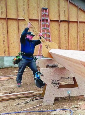

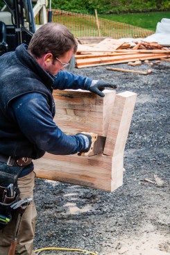

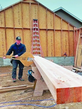

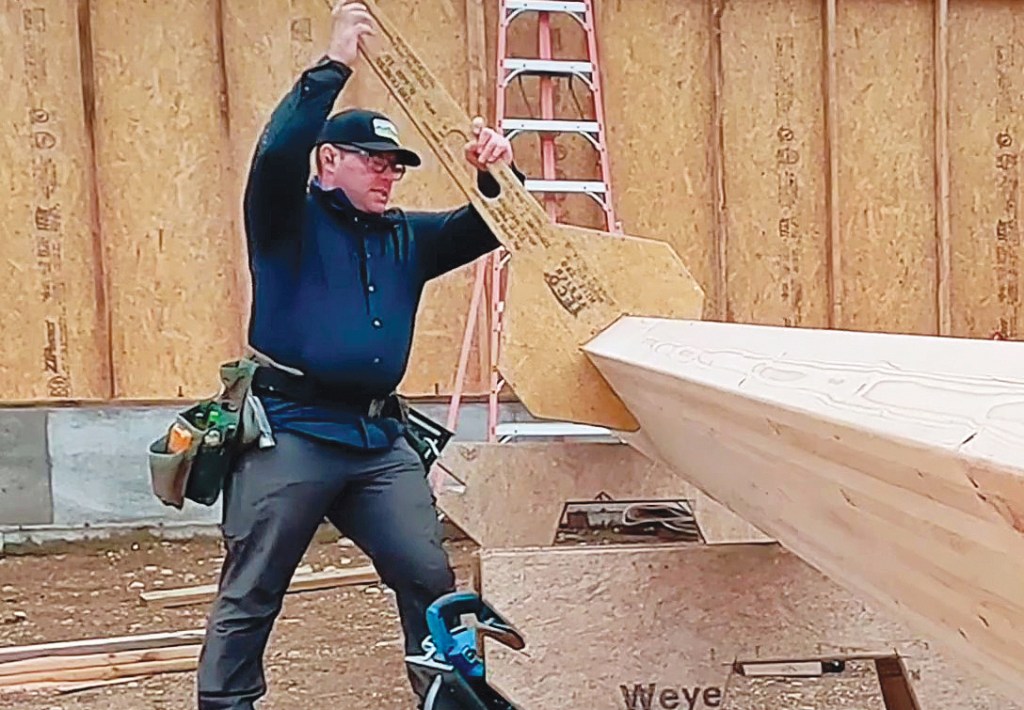

Maneuvering to cut. We often use the forks to tip a beam on edge (crown up or “top” stamp up), then pick it up and hold it on the forks at about knee or hip height so we can cut both sides while the beam is in a vertical position. That way, when the thickness of the beam exceeds the capacity of our saw, we don’t have to flip it to cut from the other side. It also eliminates any stresses that might bind the blade.
One way the author maneuvers a beam is with a “beam wrench,” which can be made on site with plywood or OSB scrap.
This simple moment arm gives the author enough leverage to tip the beam on edge safely and quickly.
Recently, we have been using a “beam wrench” (photos above). Made from plywood or OSB, this simple site-made tool allows us to quickly and safely tip monster beams on edge that we otherwise couldn’t move.

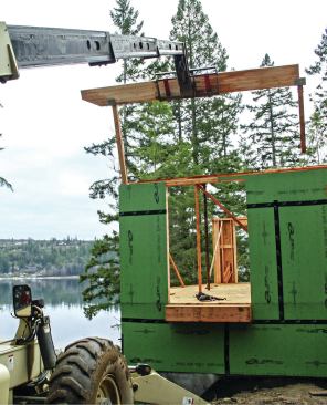

Lifting and setting. To lift a beam into place, we use two basic approaches:
1. The first, easier method works well for most garage beams and other beams that sit on first-floor walls that we have direct access to. We center the beam on the forks and lift it into place on support columns or walls.
A variation of this technique is to attach the support columns and hardware to the beam while it’s on the ground; we then lift the whole assembly into place. Often, this is the safest, most efficient way of handling the beam. We can work faster on the ground, and when we set the beam, we only need to plumb and brace it—no drilling or fastening hardware while working from a ladder.

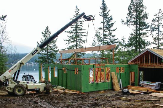

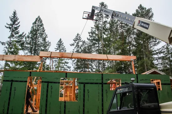

2. The second approach is to carry the beam from rigging straps. This takes a little longer but gives the guys on ladders or scaffolding more maneuverability to guide the beam into a pocket. We have an assortment of rigging straps that are rated for far more weight than we’ll ever lift. To locate choke points for the straps, we typically split a beam into thirds. The strap angle off the beam should be 60 degrees or greater. (Please note: Some states have specific rules about who can rig, so be sure to check what may be required locally.)
We often have to drive with the boom in the air, which can cause large beams to swing all over the place. This can be dangerous, but we have never had an accident because we take our time and always use at least one tag line so that the beam doesn’t swing out of control.
Hand signals. There are standard hand signals for signaling a crane or forklift operator. We’ve modified them so that they make sense to us, and we train anyone new on our sites to use our version. What’s most important is that everyone on the crew uses exactly the same signal style, and that the operator stays focused on the framer who is doing the signaling. We learn to watch the hand signals, but just as important, the driver pays attention to the signaler’s facial expressions and body language.

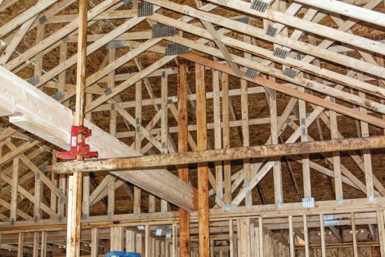

Lifting without a machine. Sometimes we have to set a beam where we can’t use a forklift. This comes up more often in remodeling situations, but occasionally on a new house, a change will occur after the trusses have been set and the building dried in, and we have to walk a beam inside and lift it with wall jacks. In one example, we had to set a 42-foot-long, 5 1/2-by-12-inch glulam. It needed to go up 14 feet in the air—and we had just three guys on the crew. To get this done, we had the lumber company drop the material as close to a window as possible. From there, we were able to slide the beam onto a section of rolling scaffolding. This allowed us to wheel the beam into place and then use two wall jacks to lift it up, bracing the jacks to keep them straight.
