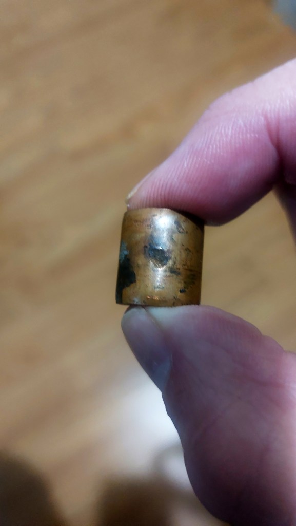

A little while ago a friend called me about a plumbing leak in her basement. The main line from the hot water tank had sprung a leak in the ceiling. Water had sprayed across the floor and onto part of one wall, luckily not for too long before she noticed it. She had already turned off the main water supply valve and was wondering if I could fix the leak or knew someone who could. I told her I would come by that afternoon with my plumbing tools and see what could be done.

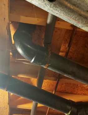

When I got there, I removed the foam pipe wrap on the hot water line where the leak was coming from and saw that a small groove had been worn in the copper pipe by the metal plumbing strapping that was supporting the ABS drainpipe. This strapping had been installed up to the framing and was just touching the copper pipe next to it. Over many years the movement of the house or pipes or both had been enough to make the water line and strapping rub one another.
Marc Forget
You can just see the strapping just touching the water line. The result was a small groove in the pipe, enough to leak.
The fix ended up being straightforward enough that even a carpenter like me could handle it. I took down the strapping, cut out the section of copper with the hole, and put in a new coupling to connect the pipe ends. Leak solved. I then installed new strapping to support the 4-inch ABS, but I made sure it was in a spot that would have no chance of touching the water line again.
