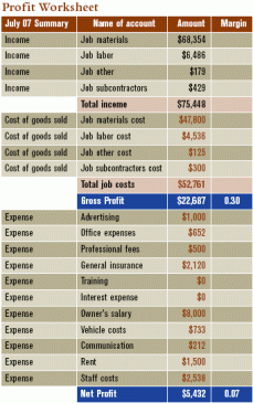

Understand Gross Margin and Net Profit
In simple terms, gross margin tells you how much profit your company earns relative to the cost of producing its products or delivering its services. (The term “gross margin” as used in this article describes that profit in dollars. Other authors may use the term “gross profit” for the dollars and “gross margin” only when expressing the profit as a percentage.) Cost of goods sold includes all costs incurred specifically to produce a job, such as materials, direct labor, subcontractors, permits, portable toilets, dumpsters, and project management.
Gross Margin = Total Sales Revenue – Cost of Goods Sold
Gross margin is the amount needed to cover operating expenses (overhead such as liability insurance, office space and equipment, sales salaries, and the like) plus net profit. “It’s important because, regardless of the gross margin on any one job, if the company doesn’t earn enough total gross margin to cover operating expenses and provide a net profit, it will not be self-sustaining and will go bankrupt without cash infusions from a source other than sales,” says Steven. Gross margin can also be expressed as a percentage, to show the ratio of gross profit to sales revenue:
Gross Margin Percentage = (Revenue – Cost of Goods Sold) x 100
Revenue
Gross margin plays a role in markup and estimating, and it demonstrates the relationship between financial analysis and estimating. “In remodeling, a 30 percent gross margin is common. To get that margin, you don’t mark up your costs by 1.3. Instead, you apply a multiplier of 1.43. You have to understand what multiplier you need in your estimating to achieve your targeted gross margin,” says Steven.
Steven explains that the multiplier (or markup) is always higher than the gross margin number because it is a factor of the cost rather than of the price. Consider this example of how a contractor with a targeted gross margin percentage of 30 percent arrives at a multiplier (or markup) of 1.43, using the following formula:
Sales Price = Cost of Goods Sold ÷ (1 – Gross Margin Percentage)
First, he identifies his targeted gross margin percentage. Next, he calculates the job costs. If job costs are $100 and the desired gross margin percentage is 30 percent, then the sales price must be $142.85:
Sales Price = $100 ÷ (1 – .30) = $100 ÷ .70 = $142.85
To find the multiplier to use on future jobs (rather than having to redo all this arithmetic), just divide the sales price by the job costs:
$142.85 ÷ $100 = 1.43
Simply multiplying the cost of any job by 1.43 (as long as your cost estimate is correct) will give you the sales price you would need to charge to earn a gross margin percentage of 30 percent.
Understanding the gross margin also helps a company prepare the next year’s budget. Gross margins that are too low mean the business can’t cover the costs of operating. The business will need to either raise prices or lower operating costs to realize a profit.

Keeping tabs on your profits requires that you first find your gross profit by tracking and comparing job costs and job incomes. From your gross profit, deduct the overhead costs of running your business to reveal your bottom line.

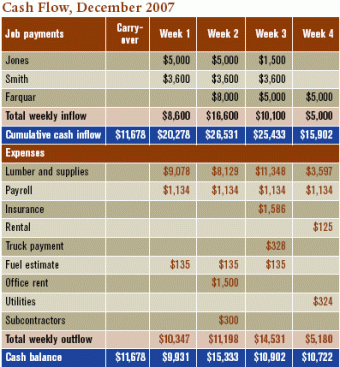

Project Cash Flow
“The number one mistake deck builders make is not buying materials and covering other costs with their client’s money,” Hodgdon says, adding that when a contractor fronts the cost of material, permits, and design, they are in effect giving the customer an interest-free loan. “I’ve seen instances where, because of cash flow crunches based on this kind of error, the company is forced to draw a line of credit and pay interest to get sufficient cash to provide their client with an interest-free loan.”
Builders may not think about the costs incurred before the job starts, such as overhead in selling the job, estimator salaries, the cost of delivering materials to the site, or equipment rental deposits. Getting a substantial deposit before the work begins helps eliminate the cash flow problems that can occur before each job.
Steven suggests taking cash flow a step further. “Plot all the jobs on a grid along with the projected schedule for payment, and you have a realistic idea of projected income,” he says. “Compare that with projected cash out such as payroll, supplier purchases, and insurance payments. You’re not looking at profitability; you’re looking at cash in, cash out.”
Projecting your income and outgo for each month identifies times when you might not have the cash on hand that you need. Knowing ahead of time allows you to address an occasional cash crunch by, for example, accessing a line of credit.
