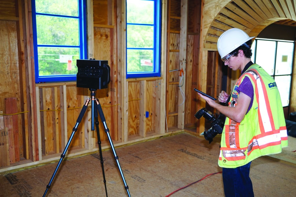

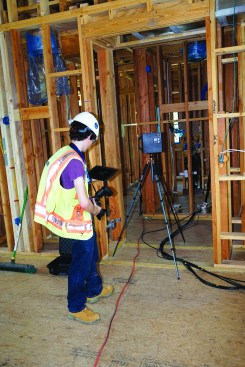

A Multivista technician uses a Matterport scanner and an iPad to create an accurate, photo-realistic virtual model of a Risinger Homes building under construction in 2018.
At the same time, the tech is taking high-resolution still photos of some locations, which can be keyed to the virtual model of the building.

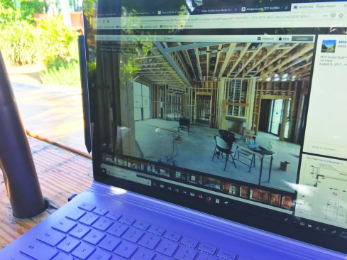

The fly-through 3-D photo model of each project shows the real condition of the walls and ceilings the moment before everything is closed up.
The service is a construction documentation process. “We coordinate with the construction team to be out there on site at the exact moment after everything has been inspected inside your walls, but just before you stuff insulation or you drywall,” said Whitton. “We wait until everyone is done working in the wall, come out and take our photos, then they insulate and drywall, and we do it without affecting their schedule. We can shoot photos pretty quickly. So we create the best visual as-built that is possible. We cover every square inch of the building. And then we link those photos to the floor plans of the project, and then we store them, or we host them online in an easy-to-use mobile application and desktop application.”
From the original solution of a collection of still images keyed to a floor plan, the technology has evolved. Now, Multivista technicians bring a sophisticated 3-D image capture device to the job. “Matterport (matterport.com) is the technology,” said Whitton, “and we have a strategic partnership with them. It’s the same technology used in real estate to create virtual-reality walk-throughs; the only difference is that, in our case, we’re walking you through the building under construction, instead of when it’s finished.”
The interface gives password-protected access to project documentation wherever there’s an Internet connection.
“There are a few different ways that we document,” said Whitton. “We capture exact moments in time—for instance, just before you pour concrete, we will come out and take photos of what’s inside that concrete so you can look back into those systems. You can basically have X-ray vision of what’s inside the concrete. But then we also offer progress photos, where we come out once every two weeks, or once a month, and we take the same photo from the same location, so that when you click on an arrow in the model, up pops a photo, and when you choose ‘progress,’ up pops a string of photos, so you can see the building from the same perspective over the course of the project duration.”
