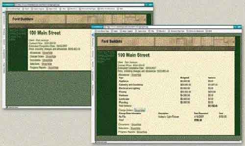

After logging in, clients choose from a simple menu (top). Clicking on Allowances and Change Orders, for example, quickly brings up the information in the same screen (bottom).

All clients have a personal login page where they can link to information about their house. After logging in, they’re presented with several selections. Under Documents, we post the contract, specifications, plans, and any other paperwork that could be considered contractual. Often there are also soils reports, structural analyses, and architectural review board approvals and comments. This information is static, so it requires only a quick upload at the beginning of the project.
The Allowance section, as any custom builder knows, is far from static, and it requires periodic updating as allowances are nailed down or change orders are written. The links to Change Orders and Selections provide in-depth information on both.
