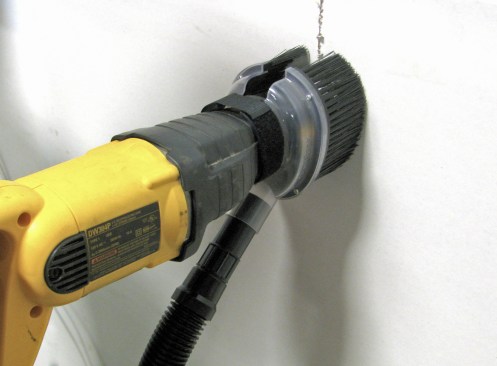

Capture lead dust at the source using vacuum-attached power tools. If a tool wasn’t engineered at the factory for dust-collection, aftermarket manufacturers, such as Dustless Technologies (maker of the recip saw attachment shown here) might be able to provide a retrofit dust shroud.

  • Use only power tools that have effective, vacuum-operated, dust-collection systems (see photo above).

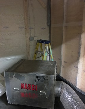

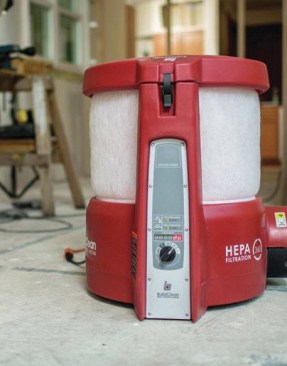

  • Consider purchasing a negative air machine to capture airborne dust (see photo below); don’t put a fan in the window that might blow lead dust all over the neighborhood.
Costing about the same as a top-of-the-line miter saw, a negative air machine significantly reduces airborne pollutants, making the jobsite safer and the cleanup easier.
The BuildClean unit pulls air from all sides, first through a prefilter and then through a HEPA filter, before clean air is discharged thorough the port at lower left in the photo above. For lead-safe operations, this port must be  hooked up to a discharge hose to eject the filtered air outdoors.

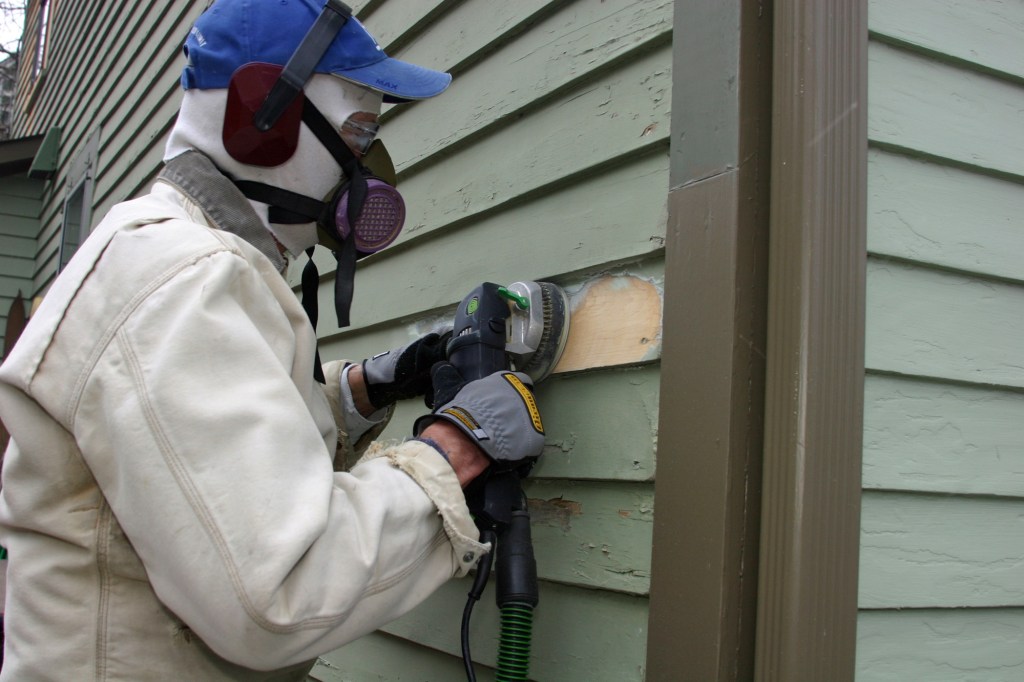

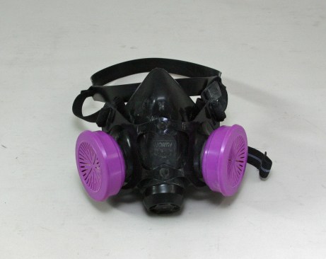

A reusable, half-mask respirator provides reliable protection for workers, but only if it is properly fit, and requires careful fit testing. They are available in a variety of sizes. This one is sized “medium.”
Experts agree that the best respirator in the world will do more harm than good if it doesn’t fit properly. “When I worked in the lead industry in the 1970s, respirators came in one size only and it was ‘Not Mine,’” says Dan Askin. “Several years later, I came upon one of those respirators and I had myself fit-tested and my fit factor was 2” (meaning that the filter was capturing only 2% of the pollutants he was breathing in). Mr. Askin points out that a half-mask respirator can also inhibit one’s ability to talk to co-workers. “If you have trouble communicating, you’re going to be taking it off and putting it back on, giving you no protection for the time that it’s off your face.”

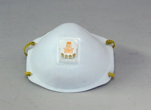

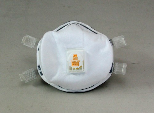

Workers who are not willing, or able, to get professionally fitted and trained should consider a high-quality disposable respirator such as this N100.
This N95 is one of the least expensive alternatives for those workers unable to get professional fit testing.
If you’re not in a position to get all of your employees professionally certified, Askin and others suggest using N100 disposable respirators (see photo above, left), which meet the same HEPA filtration standards, in a simpler, one-size-fits-all configuration. N100s aren’t cheap though. Even when purchased in bulk, they cost as much as $10 each.
Thomas St Louis, of the Connecticut department of health, worries that the high cost of an N100 makes people use them too long. “We recommend that you find a NIOSH Certified N95 disposable respirator.” He says that this less expensive alternative (shown above right)—costing as little as $3 each in bulk—is “sufficient to capture lead dust” and cheap enough to be a true throwaway. “Every time you come off the job for a break, I recommend disposing of it and putting on a new one when you get back to work.”

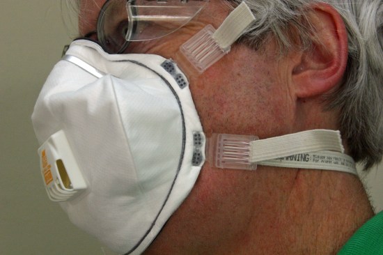

Regardless of which respirator you choose, you have to lose the beard. None of these will form a tight seal to the face unless the wearer is clean-shaven.
Hipsters take note: In order for any of these respirators to seal tight to the face, you must be clean-shaven.
Also, be mindful that after a long day’s work, the mask may well be covered in lead dust. To prevent getting a shower of dust while removing the mask, Mr. Askin says, “I bend over at the waist and I take the respirator off by grabbing the bottom and pulling it down and away from my face” (see photo below). If yours is a reusable respirator, make sure to clean it properly and replace the filters often.
To prevent a shower of toxic debris falling into your mouth, remove the mask by first bending over and then pulling it down and away from your face.

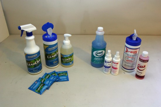

Skin. Lead dust has often been described as “sticky,” meaning that once it gets on a surface, especially skin, you have to scrub vigorously to get it all off. I never understood why this was so until Mike McKinnon explained it in terms of chemistry: “Lead is a cationic metal, which means it has a strong positive electrostatic charge. This property makes it stick to skin and other surfaces that have a negative charge.” His company and ESCA Tech both offer a variety of surfactants (a fancy name for detergents) that claim to easily strip lead from skin as well as other surfaces (see photo below). Regardless of the soap you choose, whether it’s a lunch break or an after-work shower, make sure you get clean.
A variety of products are available that may ease the drudgery of getting “sticky” lead dust off surfaces, skin, and clothing. Example shown here include the "Lead Off" products from EcoBond (right), and the product line from Esca Tech (left). Both lines are widely available from amazon and building material retailers.
