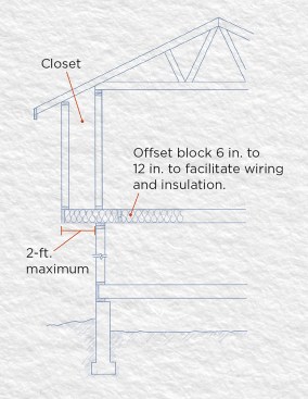

  • To add square footage (for closets, for example; see illustration, below) without installing additional foundation, cantilever the floor framing.

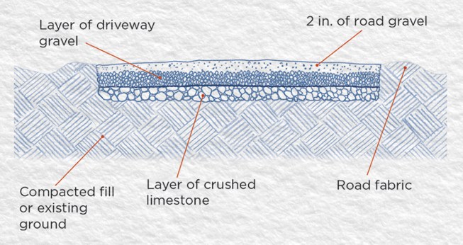

Install a gravel rather than a concrete driveway, Pagés suggests. During construction, put down crushed stone to serve as a temporary drive. Add two layers of gravel at project completion. Payoffs: Big dollar savings. Elimination of atmospheric carbonization resulting from concrete production. Prevention of rainwater runoff. Prevention of falls caused by black ice. Plus, instead of an ugly swathe of concrete, a beautiful approach to the home.

“By extending the roofline over a 2-ft. cantilever,” Pagés points out, “it’s possible to add a closet without complicating framing or making the footprint of the house any larger than it has to be.”

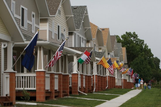

Pagés designed the interiors in this development to respond to cultural preferences of the new owners. On opening day, he placed an American flag and a flag of the new owner’s home country on the front porch.
So do I. Pagés is not a theoretician. As Duany says, he’s a man “who is in balanced measure, an artist, an architect, a hands-on builder.” He’s a man who has swung a hammer and has built 500 affordable homes including a dozen multifamily developments of six to 30 units. He’s a man who, along with building, has for nearly half a century relentlessly researched possibilities for profitably building more affordable and greener homes. All that experience and learning has been distilled into the new Building an Affordable House. The result is a masterwork.
