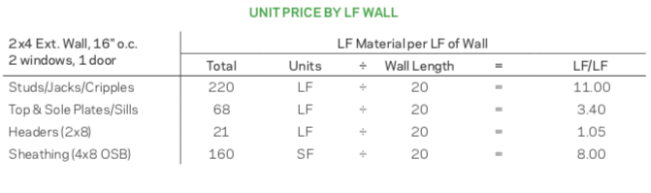

This table converts quantities to linear feet, which some contractors prefer. Combined with a dollar cost, this value will yield the unit price per linear foot of wall. (The diference between LF and SF units is that LF applied only to a wall of this height; SF can apply to walls of any height.)

Because the base wall has a total area of 160 square feet (8×20), all of the costs listed in the worksheet will have to be divided by 160 to yield the price per square foot (see table, facing page). I’ve also included calculations for a price per linear foot, which some contractors prefer. The difference is that a linear-foot price applies to a wall of a particular height, while a square-foot price can be used on shorter or taller walls, provided they are constructed in more or less the same way. A square-foot price could also be applied to a gable wall, although labor might vary with wall height and roof pitch, as well as whether the walls are framed “on the ground” or in place.
