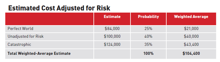

First, come up with an estimate for the job, unadjusted for risk. Let’s say $100,000. Next, come up with “perfect world” and “catastrophic” estimates for the same job. This is where your gut and years of experience come in and where you can consider the likelihood of bad weather, crew loss, sour customers, and so on. Assign a probability for each scenario. For example, you may feel that there’s a 40% chance that the job will run as usual, 25% that conditions will be perfect, and 35% that the job will be a disaster (note that the probabilities must add up to 100%).
Weighted averages can help you account for risk. Estimate your costs for best, normal, and worst cases, and assign each a probability. Multiply each estimate by its probability, then add up the three results to find your estimated cost adjusted for risk.
Create a table like the one above. Complete the “weighted average” column for each of the three conditions by multiplying its estimated cost by its probability. The total of the weighted averages reflects the estimated job cost including risk. In this example, 4.4% was added to the estimated cost to account for risk.
While you can’t see the future, you can provide a cushion against the inevitable. Your final step will be to add a markup suitable for your company’s overhead and its target profit, based on the total estimated cost adjusted for risk.
